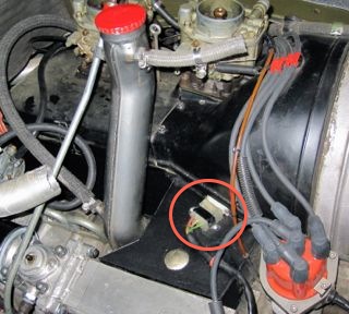

Where might one locate said molex connection?
Posts: 1639
Re: 710k running like crap
Here you go:
3-7-12 04-51 PM - Version 2.jpg (42.24 KiB) Viewed 5390 times
Remove the 2 screws that hold the plug retaining strap in place and then gently wiggle and pull the plug out. A small wire brush, an old toothbrush or preferably a Dremel tool with a wire brush can be used to clean the contacts.

I'm on it like white on rice....I was able to pull the connector and its a bit gnarly in there...I will start polishing it tomorrow
Thanks again everyone
Recon113
Posts: 24
Joined: Thu May 03, 2012 6:45 pm
Location: Sturtevant, WI
Post by Recon113 »
Well I cleaned the molex connection and a few choice swear words...I took it out for a test drive today and it ran like a champ! I will venture a bit farther some point this weekend. Thanks everyone.....beer and chili at my house! I appreciate all the help....thanks buzzz

The molex connector seems to be the mother-in-law of the Pinzgauer world.....aging and prone to failure, the cause for so many problems.
Since it comes up often in posts, and is commonly unknown to new owners, I nominate the above picture for the technical section.
