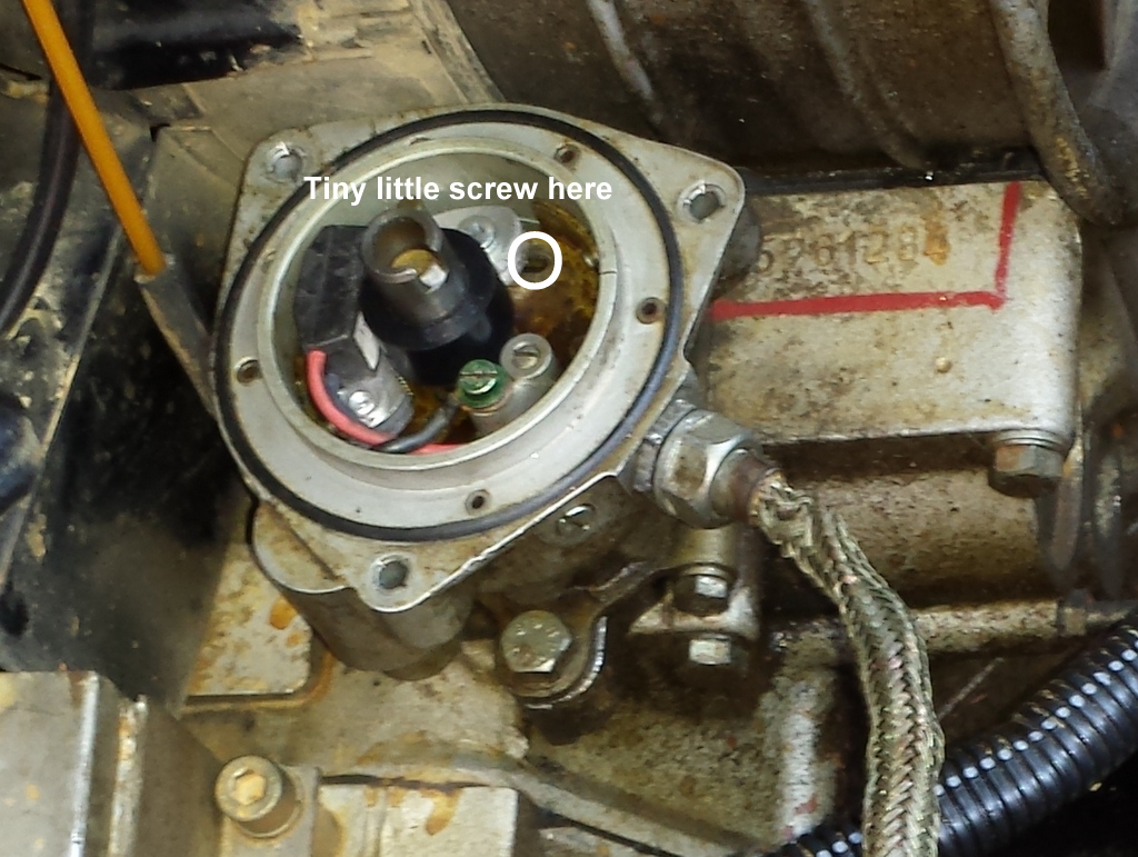

(4) Inside my distributor, I've got the magnet and setup height all confirmed. Yeah! But, there was one very odd looking 'offset' screw/plug near the end of the spacer plate. It was tiny. It wasn't threaded on the other side, and basically "fell out". I have it still --- but don't see a similar screw in the EI videos anywhere. What is it? What does it do? How do I reinstall it?
Got me there- I'll look at the diagram and try to figure it out.

#11? If so, you don't need that little guy- part of the point system.

#8 is the little piece that came out.

#8 is a cam used to adjust the points, as your distributor is now without points #8 becomes pointless also.
Or to put it another way put #8 in the same spares box you put your old points in, just in case you need to convert back to points ignition if the Petronix unit fails out in the woods.
