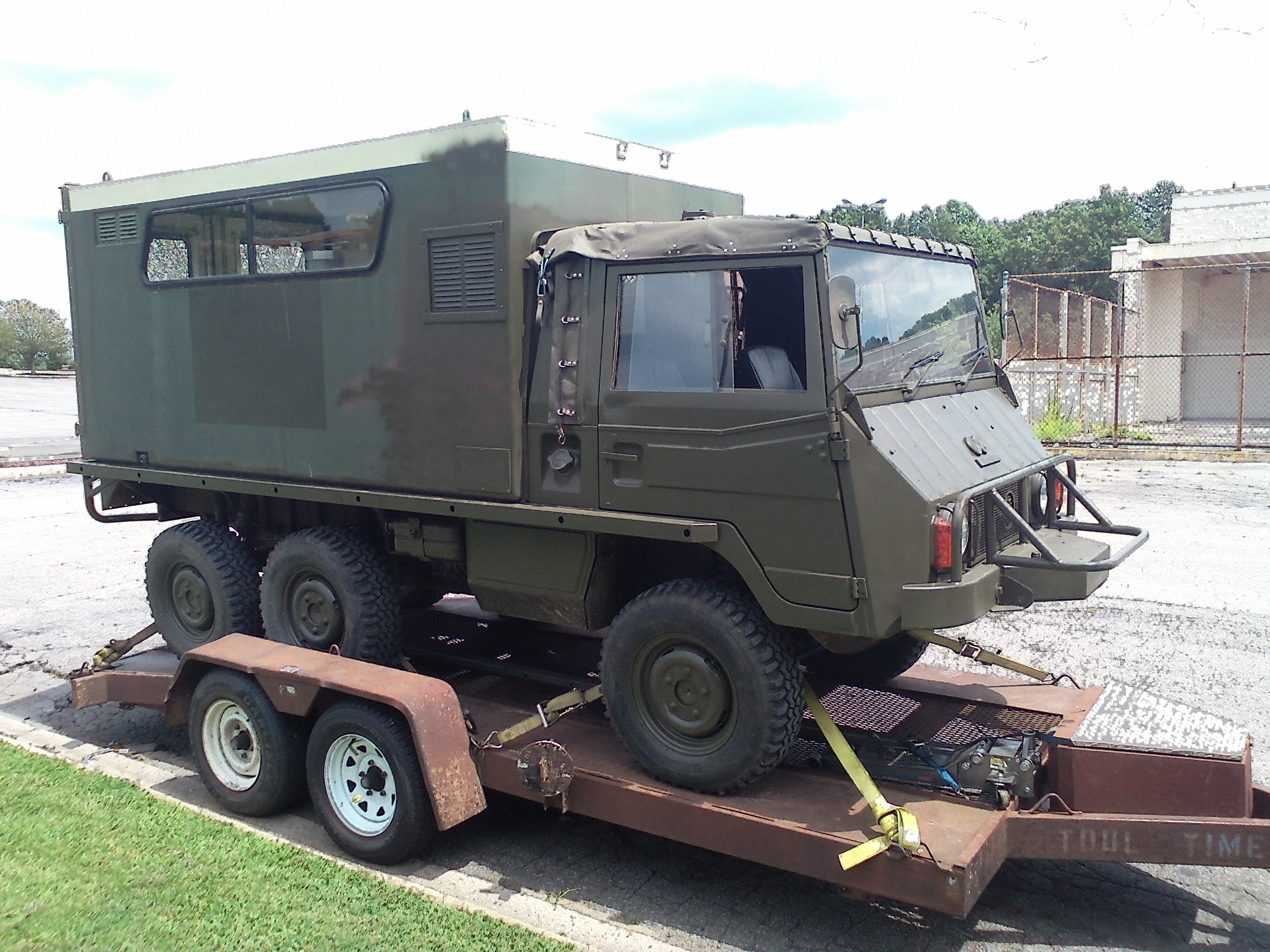

OMFG! This is not a paid endorsement, but OMFG !! Andre (Fat Fabrications) was in town yesterday and slammed this kit into my 78 710M. Absolutely transforms the truck. Smooth as silk, purrs like a kitten, easy on the ears, easy on the nose.... etc. etc. Insane transformation of the running performance of the truck.
Andre did the install last night, and this morning I put about 50 miles on it in extremely humid, changing to very very hot weather. Just fantastic. Bottom line, dig through the old sofa cushions and find all your loose change. Buy the PinzSSI. It's super sweet.
