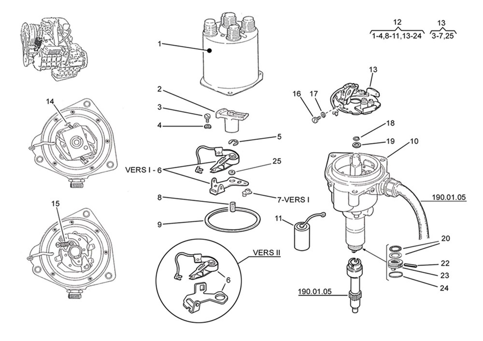

I just found a spring in the box where I kept my Pertronix. I have a feeling that it should’ve been installed when I replaced PinzSSI with Pertronix last weekend. Where does the spring go?

bbonomo wrote: Sat Aug 15, 2020 3:07 pm I just found a spring in the box where I kept my Pertronix. I have a feeling that it should’ve been installed when I replaced PinzSSI with Pertronix last weekend. Where does the spring go?
a single spring is item 15, with dual springs it is 14
Albert
