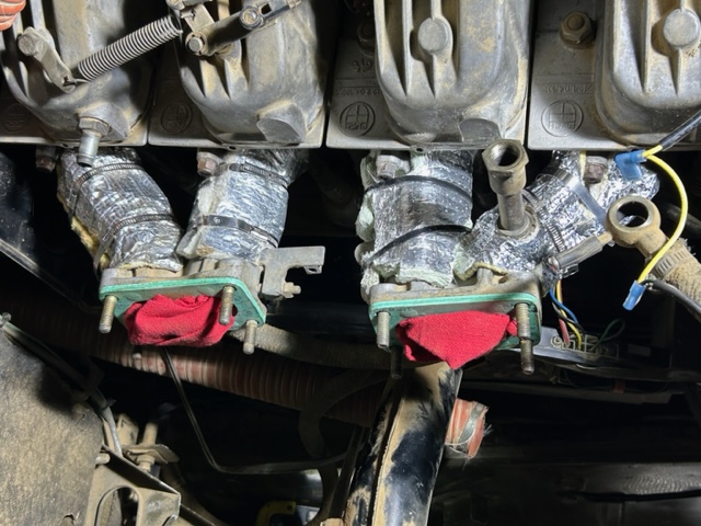

Made me think about the two major types of intake manifolds (Pants). One set
are bare aluminum, as was in my case, the other is insulated. Talked to Jim L. the
insulated version was done for the Hot Climate version of the Pinz, That's interesting.
It all makes sense to me now, I believe this was a mode to prevent heat soak. Since
the intakes are directly in the cooling air stream, as long as the engine is running I
don't think insulated or not matters -but- when you turn the motor off, then insulated
would make a huge difference as the intakes will get very hot sitting directly over the
heads and cylinders.
Ordered the pre-cut insulation from SAV, they can be installed by removing the top
tins, Carbs, and the side tin. Pix below of before and after, I used Stainless Steel ties
but ran short. I'll gussy up that one Pant leg next time I'm in there. I won't know how
much this staves off the issue until next time I'm up in elevation and it's hot.

That was enough to tell me the pump was working AND little fuel was needed
to fill the bowls. So I'm still betting on the intake "pants" heat soaked and
evaporating the fuel very lean. Puch added the intake insulation especially
for hot climate -- it then became standard.
