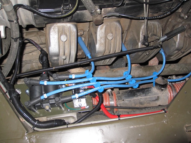

Just finished installing mine today. The fact that I could do it on my own is testimony to the fact that this requires very limited knowledge (I did learn in the process that it helps to get the gearbox in neutral before cranking the engine by hand...):-)!! After setting the timing again the engine started right away.
The kit contains everything needed, down to zip ties and electrical connectors, and the instructions are really detailed and step-by-step. It has been obviously thought through and it shows. I deviated from instructions to add a ground wire on the coil support plate. Instead of adding a screw through the truck's sheetmetal, I extended the wire about a foot and a half to the body grounding strap, just outside the battery box.
The only point that I checked and re-checked without being 100% happy is how close the throttle command rod is to the coils connector, but I guess I am worrying for nothing as it seems nobody reverted saying this is an issue.
I haven't done a test drive like I wanted yet, as I was out of daylight by the time I finished, but I will tomorrow.
Thanks a lot for designing this and selling it as a kit, this is quite an improvement over the stock setup.

GenevaPinz wrote:The only point that I checked and re-checked without being 100% happy is how close the throttle command rod is to the coils connector, but I guess I am worrying for nothing as it seems nobody reverted saying this is an issue..
I had the same concern (probably needlessly) so I covered the throttle rod with some plastic split loom that just sort of floats on the rod. Besides acting as an insulator I'm also hoping it prevents any chafing with the various wires. (note: I made my own spark plug wires for reasons unclear to me at this point :? )

I put a layer of duct tape on top of the connector to shield it somehow, and I will keep an eye on it for any abrasion from the throttle rod.
After realising that I had put the doghouse and seats back without re-plugging the coils (it turns out you can put the plug back in from below... :roll: ), I could go on a short test drive. The idle is much steadier and the truck just performs better accross the whole rpm range.
Great modification, very simple to install and highly effective!

Has anyone done this on an Austrian pinz? After looking at this picture I realize my seat belt mount sits right next to where the coils are.. Worried that they will hit.
