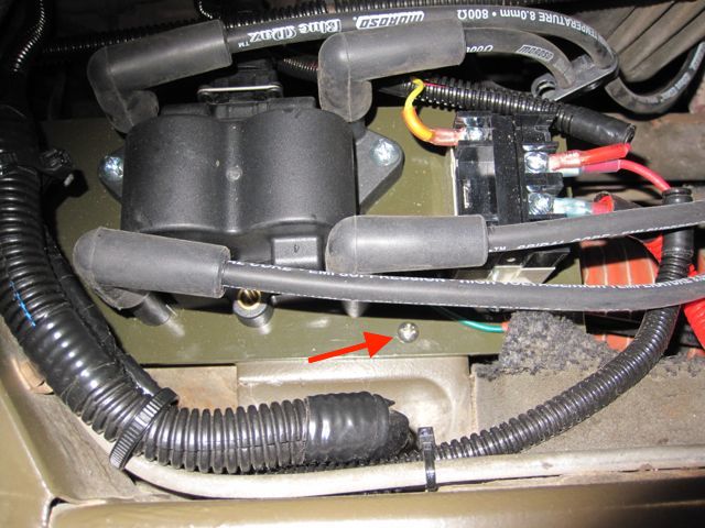

After fighting a nasty cold and the frigid temps last week I finally got mine installed over the weekend and I'm very happy with it.
I did a lot of pre-planning since I wasn't able to get right at it and the install went very smoothly. I also ran the main harness over the top of the front tin where the spark plug wires used to run. This is purely a personal choice as it fits either way.
I had the warm air regulator installed on my air cleaner so instead of plugging the vacuum line I just removed the previously installed "T" fitting and connected the regulator directly after removing the distributor line.
I mounted the coil pack/relay as directed but added another ss screw (red arrow) into the frame for a more secure mounting. To determine timing I divided the circumference of the pulley (approx. 508mm) by 360 degrees. The result was 1.41mm per degree of rotation. I set the timing pointer at 10mm (3/16") BTDC which is about 7 degrees BTDC if I'm correct. In any event the engine started right up and purrs like never before. I have the advance switch set at 2. It's still too cold for a long drive but it ran great on a 5 mile trip. Haven't tried any hills or off-road yet but will report back when I do.
Edit: Forgot to mention - my previously installed VDO tach worked fine when connected to the signal lead from the new ignition. No changes needed.

I have mine set at 7/16" BTDC currently and it runs good but seems to have a sputter in the lower RPM (below 2000 or so). Above 2000 RPM the thing takes off.. so I might need to play with my timing some more. I need to do other maintenance items like my carbs/valves as well which may solve that issue.
Where you put the extra screw is where I mounted the coil pack with two threaded holes.
