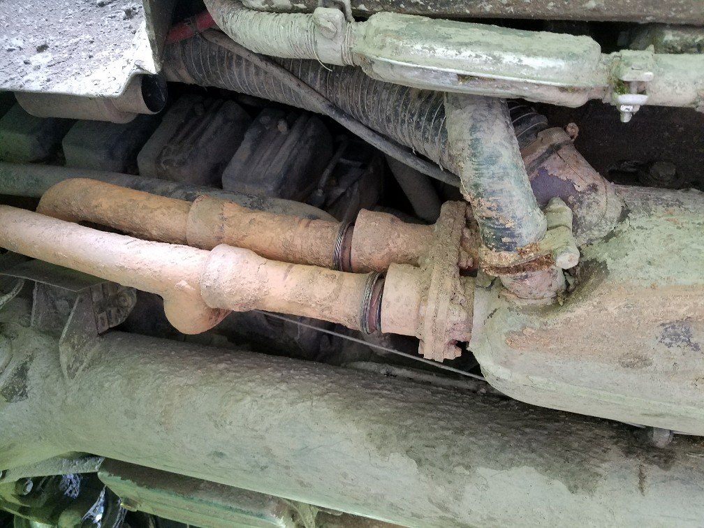

I have recently upgraded to SSI ignition (why did I not do this sooner?) and newly rebuilt carbs. Vehicle runs great but has a popping in the exhaust on deceleration on a downhill slope. I suspected exhaust gaskets and poked around looking for carbon tracking around the manifold but found no sign of a leak. I did check the rest back and noticed some carbon around the two short pipes which join the exhaust manifold to the heat exchanger. Looking at the drawings in expedition imports I was surprised to see no apparent exhaust gaskets or donuts between any of these parts!...just a steel ring and some type of snap ring on either side of these two short pipes. I am aware that many are converting this setup to a kit made by EI but I would like to stay stock if possible. Is my exhaust leak a result of the expanding snap ring that may have rotted and blown out? or is there a gasket that I am unaware of? also I was able to spin those two pipes quite using only a finger is that normal?....thanks for any insight

All of what you found with the 2 short stock pipes is normal. The snap rings and "bell shape" are supposed to provide a good enough seal but over time they rust/corrode/wear and allow exhaust gases to escape. Consequently the exhaust back pressure decreases and causes the popping sound you heard. I understand your desire to remain as stock as possible but the flex exhaust kits really do fix the problem and contribute to a smoother running engine, especially with the PinzSSI installed.
Cheers!
Re: Stock Pinz exhaust questions
Because the exhaust gasses are moving quickly, there is a negative pressure within the exhaust that sucks in fresh air through any openings. This fresh air adds oxygen that allows the hot, fuel-rich exhaust to ignite that produces the popping/backfiring. Because the rings wear against the bell ends of the short pipes due to engine movement, both need replacing if you want to stay stock. They are really well worn if you can spin them with a finger!

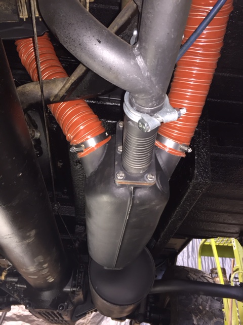

Updating the exhaust is very rewarding. You should do it.
IMG_4016.JPG exhaust2.JPG (137.78 KiB) Viewed 9458 times
IMG_4023.JPG exhaust1.JPG (127.58 KiB) Viewed 9458 times

Looks excellent. You forgot to ceramic coat the clamp. :)

You can bet when it's time to cross this bridge on my truck, I will go for the modern fix. How could you not want a system like whitesik's? That's some exhaust porn right there!
