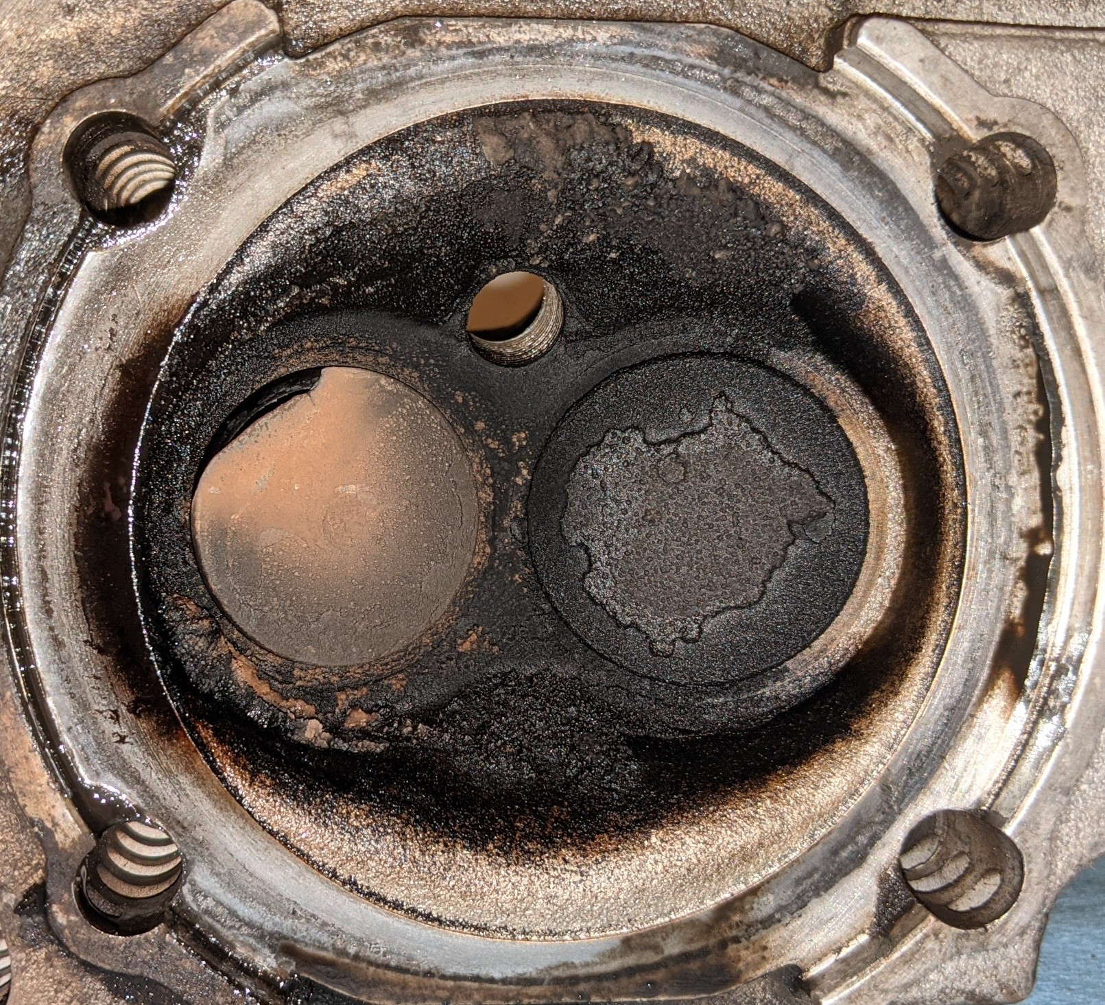

I removed the fourth head and found the exhaust valve to have a piece missing on the edge. Is this what they call a burnt valve? No pieces were found in the cylinder.
Currently I am trying to determine the cause of this. Could it be the lean condition from an intake leak that would cause the burnt valve?

Can you post a picture of that valve. A pix is worth 1000 words :DD

Burnt and appears recessed. Probably was running lean.
It would be wise to assume more than #4 is in need
of a rebuild. Or...you could roll the dice on #4 and hope for
the best -- what was the static compression on 1,2 and 3?
