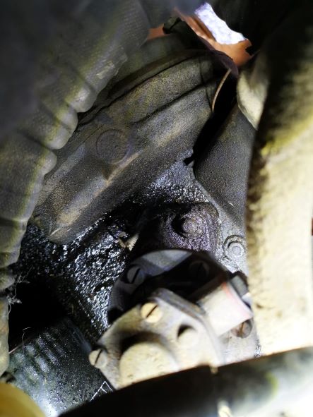

the rear nut holding the tin .

Post by Weebal »
This rear nut is where oil was bubbling out.

Post by Weebal »
right were my finger points

Hmmm, that's mighty odd.
All the M6 studs that hold tin are in blind holes so Oil can't just leak from the block.
Couple of thoughts, first would be the Lifter housing where the push rod tubes
terminate to, possibly a failed gasket. But you would also see oil leaking down
below from the bottom cylinder tin.
Another possible is the Fuel pump, but I presume that would have jumped out
as the source immediately.
From my own experiences chasing phantom oil leaks can be very sneaky.
Often the best first thing is to clean clean clean than observe -- but things look
mighty clean already, even around the Cam gear housing !
About how much Oil are you leaking say per 1,000 miles?

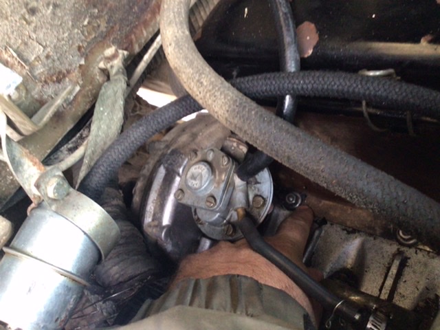

Well , I took a bunch of tin off to get a better look at things and decided the oil has to be coming from the fuel pump area. I then took the fuel pump off and cleaned the gaskets and used gasket maker and the leak seems to have stopped. I’m not sure how the oil migrated over there but it has to be where it came from.

I knew I had a bit of oil leak under the starter,
so after reading this post, I opened up the hood and checked the fuel pump.
Indeed it's pretty gunky in there at the base.
So I sprayed some WD40 and cleaned-up as much as I could.
Started the engine and ran for a while, could not see anything suspicious.
But I'll monitor it for a while.
If I see oil coming back, as a next step, should I juts tighten up the nuts ?
Or should I already change the gasket ?
That would be #27 on this page ?
https://www.puch.at/en/products%20&%20s ... el-system/
Seems there are 2
Is it a sensitive task when you pull out the fuel pump ? I've got the repair manual, seems like straightforward.
Anything I should pay attention to ?

Yes, there are a pair of gaskets (same) on each side of the pushrod "interposer".
It would not hurt to check to see if the two nuts have loosened, giving them a
bit of a tightening. Also thoroughly clean the area to confirm it's leaking. If so,
it's pretty quick and easy to replace the gaskets.
P.S. if you are still seeing oil leaking near the starter motor but no evidence it's
coming from the fuel pump mount, then check the area around the oil cooler.

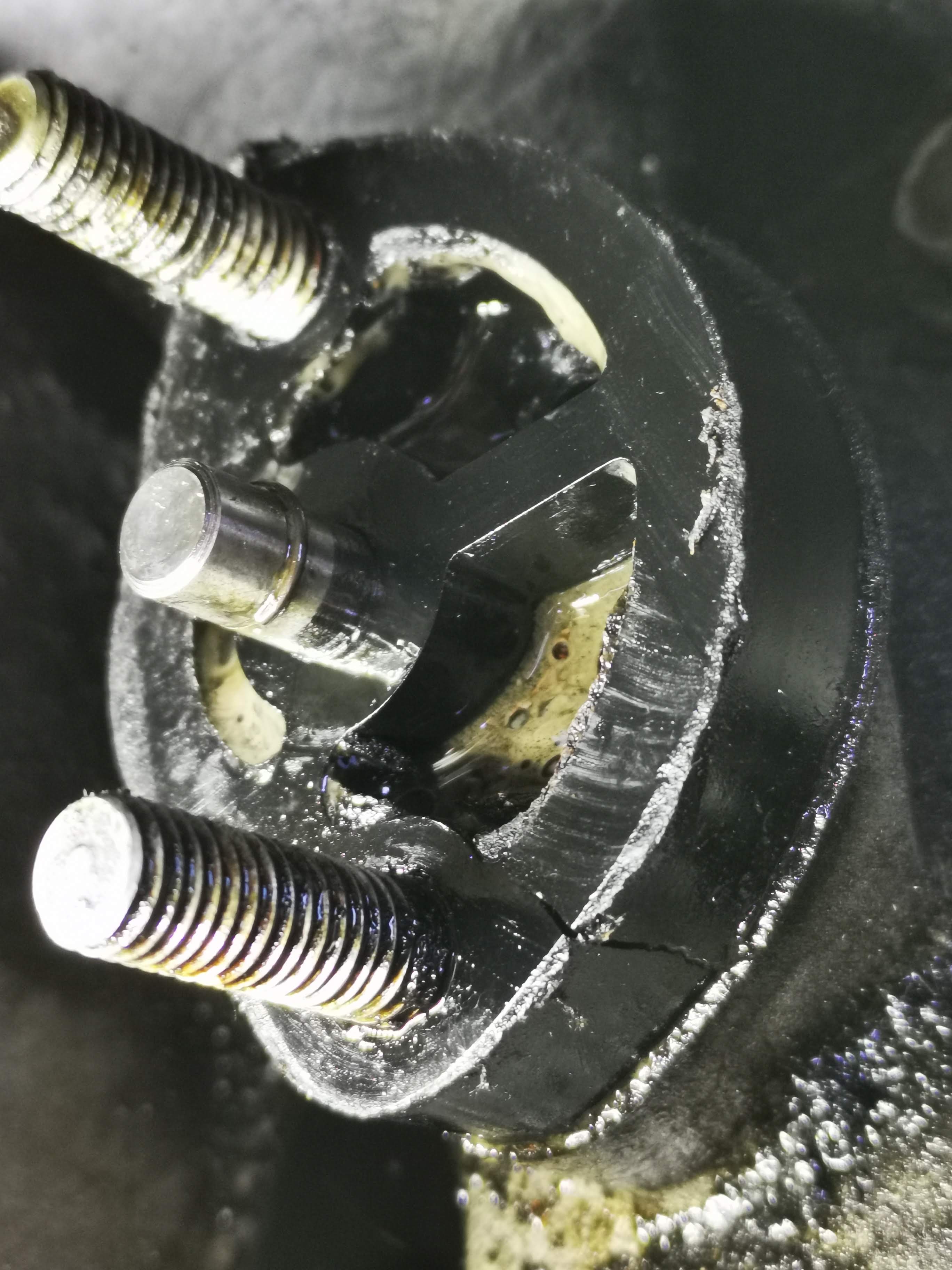

So, removed the top of the fuel pump yesterday to change the gaskets,
i realised the base of the fuel pump is cracked, not sure how can this happen,
so i'm looking to order a new one, i did not pull it out by fear of worsening the problem,
put some grease inside the crack hoping it will last a few more days,
Hugues
