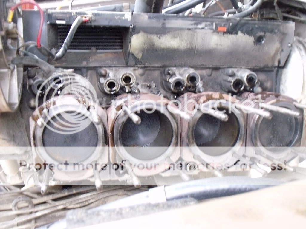

well after a few cranks #1 was bouncing back was up to 90 but 4 was still 0 so i took it apart and found #4 to be missing the bottom of the piston so after 10,000 km on a rebuilt top and cylinders checked and honed and new pistons and rings not too happy.here are some pics to see if anyone else has come across this and to why it might happen. next i guess i'll pull the cyl and see if its ok i could put the old piston back in or maybe its time to see about the mb 2.9 diesel and how close it would be to install. normally a 350 chev goes into all my toyotas and vegas in the past.ImageImageImage[/img]

I had the same symptoms happen to me on a chevy Blue Flame 6.
The cause was a small bolt that somehow got into a cylinder and
poked a hole in a piston on the up stroke...I have the old piston
somewhere and will post a pic if I find it...it has part of the bolt
inbedded in it. this was on the homeward bound portion of a 1200
mile trip and I was only 100 miles from home

It sure looks like a nut or bolt got sucked into that cylinder and beat a hole into the piston.

looks like all the screws are still all on the carb and don't remember dropping anything down there we had a good cold snap for a week -20 and she sure didn't want to start when she did it sure wasn't pretty.so now it looks like the cyl will have to be bored all the others are in nice shape but if i bore one i'll have to do all so looks like i'lll need new pistons again. i see swiss army vehicles has up to 93mm mine are already 92.5mm so i hope they can clean up the cyl with just .5 our is it worth just going for the 2.7 liter conversion.
this is one ugly looking piston

Paul nothing went into your piston the damage is from to much heat or timing to advanced sence the rings were not damaged one other thing that may have caused this is to lean fuel mixture caused to much heat. Swiss army has all the parts you need be sure to get the correct piston size and jug bore size.

Your piston failed due to 2 things, #1 leak at head to cylinder surfaces(notice black marks on heads and cylinder mating surfaces).
I do sell Arias pistons and can provide cylinder boring services.
You must also pull and inspect the camshaft bore plugs(most common top end failure)
If the bore plugs come loose you loose oil feed to the piston skirts.
I also offer a high torque cam(exchange required).

Paul Gudmundson wrote: we had a good cold snap for a week -20 and she sure didn't want to start when she did it sure wasn't pretty.
Any chance starting fluid “ether” may have played a role in this?
