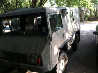

I had the exact same issue when I got my 710K back from the paint shop (no gloss, flat papyrus tan, love it!). I noticed a breaker had popped and pushed it in, but problem stayed (think there was a slow short somewhere).
Thought it was a carb problem. After reading this I jiggled the switches and presto, problem gone. Many thanks.
