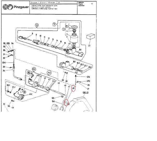

Hi All
I have just dismantled my clutch linkage and I have found a small clip that needs replacing and I cannot find the part# in my parts book. It is wire clip that retains the clutch operation arm onto the ball that is fixed to the gearbox end of the bellhousing. It is bent and needs replacing. There is a smaller clip that retains the rod that engages with the slave cylinder to one end of this arm but it is not this one it is the larger of the clips that is in the middle of the arm that the arm pivots on.

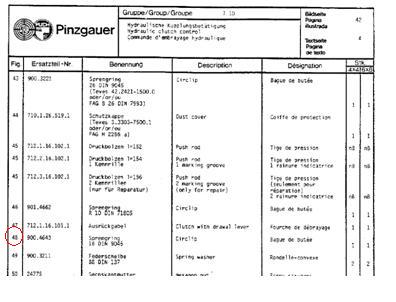

Re: Throwout Bearing Arm Clip
Figure 48 900.4643 Sprengring / Circlip “16 DIN 9045”
is this the one you are looking for?
Post by SAM. C. »
Thanks Ed
Thats the one.
Sam
Post by Jim LaGuardia »
PN# 9004643
