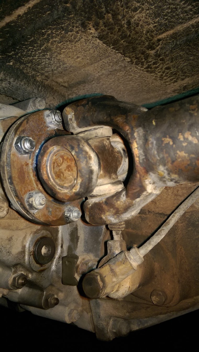

The reason I ask, and I feel a little dumb, is that I cannot find all the grease fittings. There is one on the shaft, but the other two, I am at a loss.
I noticed the marking "USA 371" on the u-joint closest to the hi/low transfer case. Something tells me not original Swiss stock? Also, when looking online, I found a diagram with that looks like two types of shaft, one with three zerks #19, and one with only one #7
I am willing to concede that the zerk fittings could have been sheared off, but I don't see a hole. Where exactly would you look? On the U-joint itself, or on the flange or slip yoke? I hope I am getting the technical terms right.
Is it possible to have a u-joint that is not greased, this does not sit well with me.
Any thoughts would be great.

Many U joints that I have replaced (on US car driveshafts, back in the day when they were all rear wheel drive) were considered "greaseless" without a zerk fitting; some original U joints had zerks and replacements did not, or sometimes they did not and the replacements did. If they had one, the zerk was always on the cross, usually between two of the arms and often pointing somewhat forward or back to make it easier to get a fitting on it. If you don't find one, nor a hole where one was, then you have a lifetime sealed U joint.
I have no idea what may have changed over time with the factory driveshaft, but I've never noticed that greaseless U joints had a shorter life than greaseable units. I'd suggest you grease what you can; if they fail, replace them. Any of us with greaseable units just do the same - grease what we can, and replace what fails.

Pretty much the life of the truck. I've never heard or experienced a single case where U joints were ever replaced more than once, on any vehicle. If they ever need replacing they are inexpensive but can be a real pain if you don't have a press and the knack or experience to change them.What is the life expectancy of a "propeller shaft" as it's called in the parts catalog?
You will notice a definite vibration (can be severe) when they fail as the bearings at the end of the cross no longer hold the shaft centered; it starts to spin off center, creating the vibration. However even in this condition they will hold on for a long time -- meaning that you don't have to worry about being caught out on the trail with bad U joints; you can easily "limp" home (at reduced speed, due to the vibration at higher speeds) for quite a long way.
Personally, from the photos you posted I would put the driveshaft wwwaaayyy to the back of my mind; you may never have a problem with it. Grease what you can and don't worry about it.

I agree with Jim about not worrying. As was mentioned before: Yours are just permanently lubricated. If and when they fail, then replace them. Don't worry too much about a lack of zerks.
The only prop shaft on a Pinz I ever saw that was "bad" was probably still okay. The Pinz driveline doesn't move much, and the alignment between the transmission and transfer case is pretty straight. The u-joints don't have to flex much with each rotation. So they tend to stay free only in the degrees within which they do move. But beyond that normal small amount of movement, the "bad" one felt sort of tight. On any other vehicle, I'd have replaced the u-joints. That particular prop shaft is still working just fine, many years later.
If you cannot feel slop in the u-joints themselves, I'd leave well enough alone and sleep well at night.

I spoke with the PO (needed help with the title transfer) and he confirmed they are after market drive-shafts. Sealed units.
