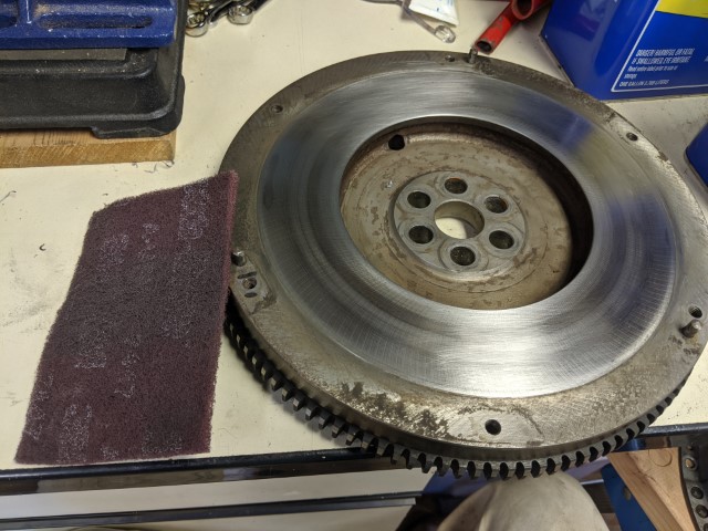

Yep. Nothing left of one side of the disc. Even found a few chunks wedged in the spring tines.
The flywheel side has 4.0mm of material remaining and dust grooves still visible. Not sure what the original material thickness was.

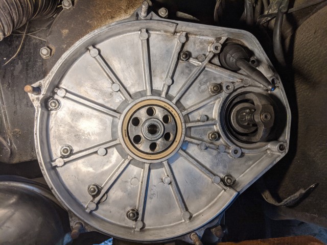

This was my first time removing the transmission, clutch, and flywheel on a Pinz, and I wanted to share a few thoughts from an experienced mechanic but one new-ish to the Pinz. Much of these bits of advice and observations have been echoed by others before me:
- You can do this whole job from inside. In the future, all I'd do on the outside is to stack up cribbing to support the rear of the engine, and position another stack about a cm below the transmission to rest it on.
- Inside, put a 5ft 2x4 across the transmission area, and a ratchet strap under the transmission as a *safety* strap. On installation, don't make it snug so you have room to wiggle the transmission back into the pilot bearing alignment. That last part is why I suggest keeping that cribbing slightly low so you have wiggle room.
- After unbolting the driveshaft from the transmission, it steel wires up nicely to an inspection cover hole.
- Do not attempt to replace the clutch disc without an alignment tool as it's a close fit to the pilot bearing. I'm keeping that tool in the truck now in case I need it on the trail.
- If your clutch disc frags, you really need to pull the flywheel to get all the pieces out.

- Clean up (de-glaze) the flywheel surface with a red 3M pad.

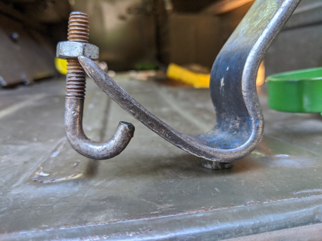

- Pulling the pilot bearing out of the crankshaft was easy with a J-hook bolt and a Vaughn Superbar. To replace, just tap in gently with a large socket as the flywheel installation will push it into place later.
