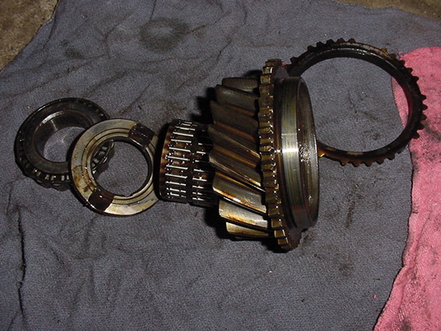

Jer, when you find it is still popping out of gear with the cable off, it is time to pull the transfer case. Just to be clear as clean water "Engine and trans mounts will not affect transfer case operation".
I have rebuilt enough of these units to know by symptom description you will be pulling the case out for repair.
Parts to have on hand would include all 7 bearings(including locker box),gaskets and seals, high speed gear, both needle bearings(high and low), syncro slider, syncro dog springs(#23 in diagram). I would check the syncro rings, if they are not grinding going into range and are undamaged, they can be re used(spec in book). A syncro ring is like a brake shoe to stop the gear so the collar can slide and engage the gear splines, they seldom fail.
Look in the archive section for removal posts.
Or you can pull it, drain it and ship it for rebuilding :idea:
P.S. the cable has a wire retainer at the ball end, flip it up with a scribe and then remove it to release the socket from the ball.

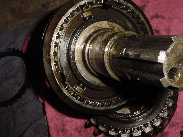

Here is a side view of the syncro hub and slider, notice the springs on the syncro blockers, when they fail(break , rust, loose temper) it will not stay in gear for long, the sleeve starts to wobble and wear the mating surfaces away.
