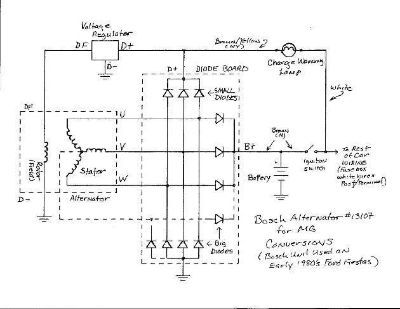

See schematic of a typical alternator-regulator circuit attached.
One possibility is a bad connection from the sensing terminal D+.
If this is low the regulator will drive a higher voltage to the field
winding then the output B+ will also be above nominal. 30V implies
something like that may be going on. Try getting a meter on that
terminal and see what that voltage is, if working properly it should
be close to the output voltage that connects to the battery. If
significantly lower that is a good clue. Could be a oxidized connection
or blown diodes in the alternator, there are 3 small diodes used for
sensing, one bad or more could lead to a problem, that could
although they typically don't fail as they are relatively low current.

Re: 710K over-voltage
Thanks for the reply. So in your diagram, the Voltage Regulator is integrated into the alternator and not the separate part I replaced that is mounted in front passenger corner of the engine compartment?
-Erik in Colorado
I lifted this schematic as a Google search as an example only.
The schematic is correct in the sense of the "how it works".
Indeed, the Pinz has the Regulator external, in some cases the
regulator is integrated into the Alternator housing. Just
ignore that. Find the D+ terminal on the connector near the fan
housing and get a meter on it. Let's see what that voltage is
when your output is over 30V.

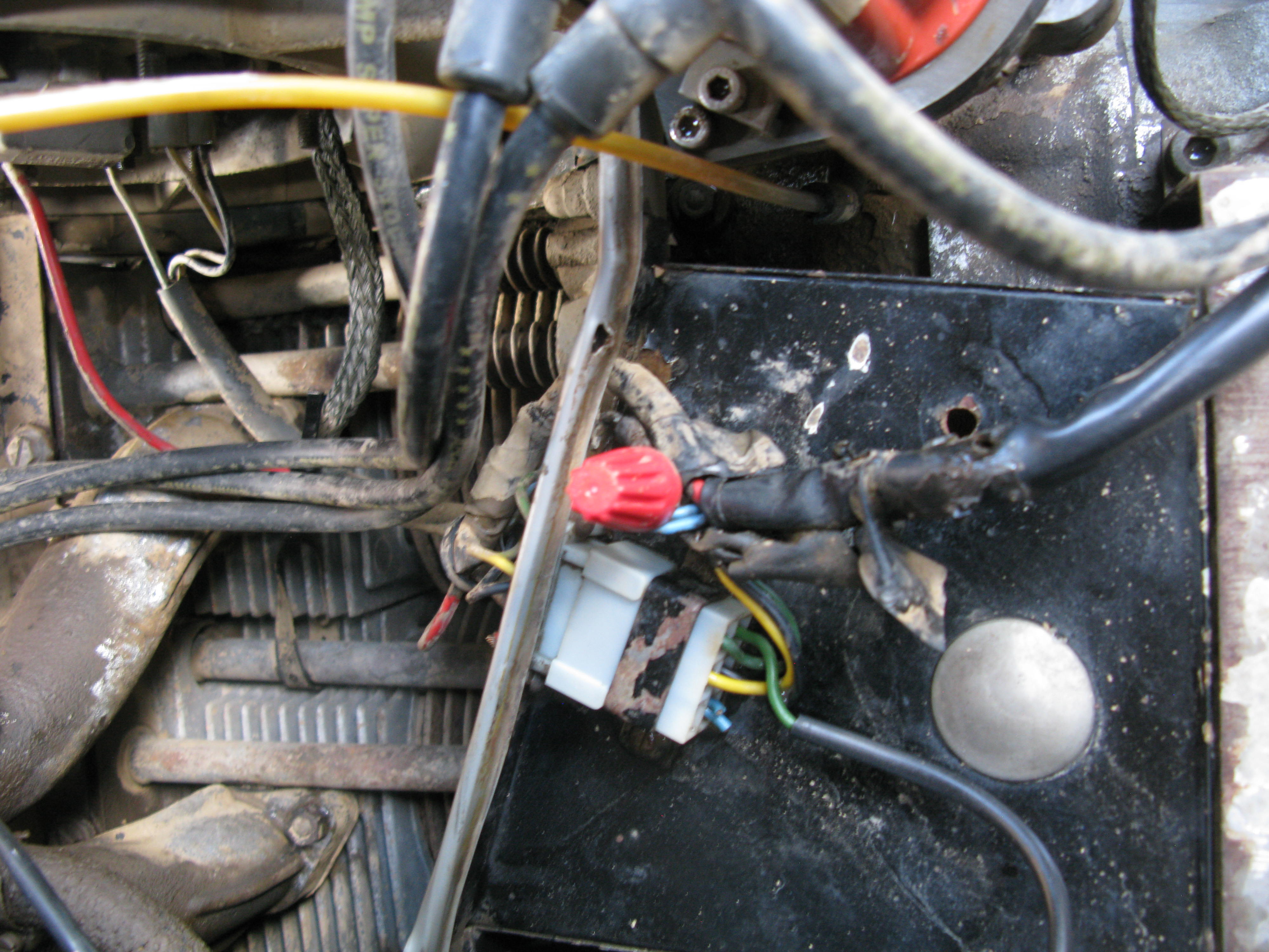

Solved! The problem was the wiring from the alternator. For some reason a prior owner bypassed the molex connector and had the red wire wound in with a bunch of other wires and wire nut. That connection was the problem. Redid that and no more 4500 light and no more over-voltage.
Ah yes, you are correct. It was the blue wire that was badly connected using a wire nut, not the red wire. The wire nut was red. Its so ugly what they did.
