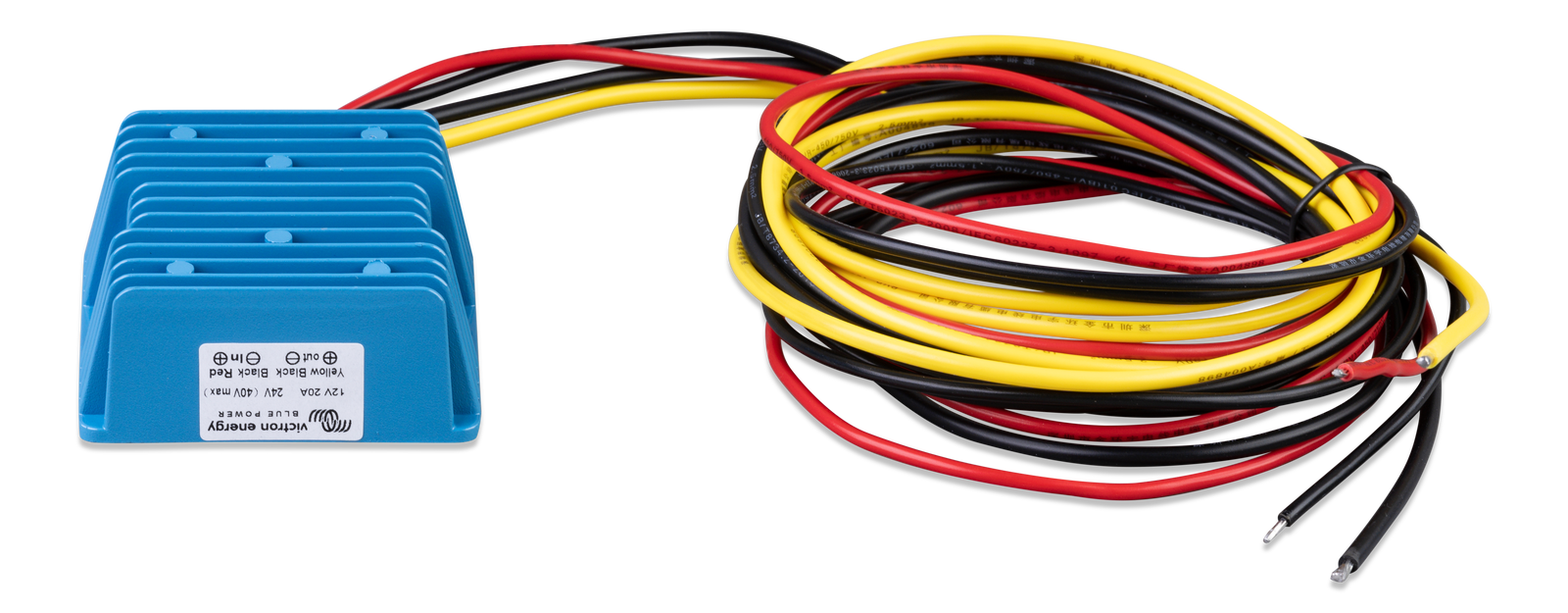

As my requirements for amperage draw are so low and insignificant, I think I'll go with the fully potted IP67 20 amp converter and see how it goes.
1609414511_upload_documents_1600_640_q90-ORI241220260_Orion IP67 24_12-20A (front).png
1609414511_upload_documents_1600_640_q90-ORI241220260_Orion IP67 24_12-20A (front).png (897.06 KiB) Viewed 7407 times
I'll update once it's up and running.
