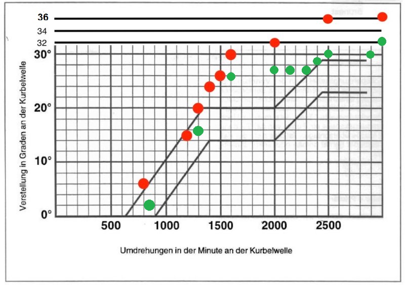

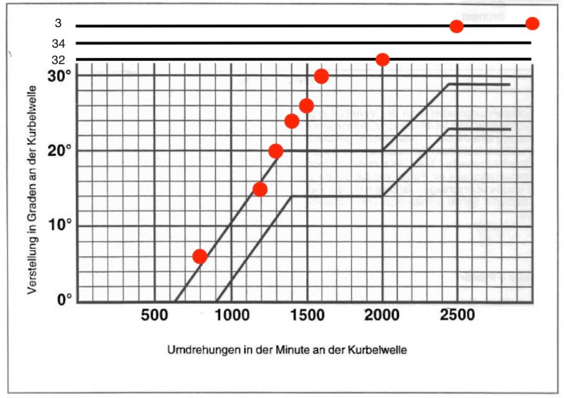

I bought a timing light and checked my advance at RPM with warm engine,
as you can see in below chart, above 1300 rpm, my advance (red dots) is too much compared to normal range
I would think the springs in my distributor's centrifugal system are not stiff enough anymore.

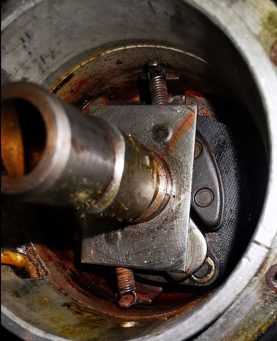

Removed the distributor cap today, as pictured below, how can you replace the 2 springs ? that shaft and rectangular plate does not appear to move out, at least not when pulling on it a little.
Any advice ?
as can be seen in this video of a Bosch distributor (different model but similar), the rectangular plate and cam shaft can be removed to access the springs.

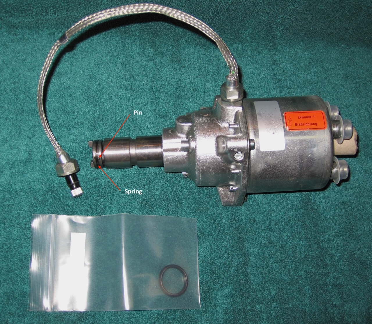

If I remember correctly, you will need to remove the distributor from the engine and then carefully remove the spring and then the pin that holds the drive cog to the bottom of the shaft. You should then be able to remove the entire shaft assembly from the distributor housing and will have access to the springs.
Hope this helps.

Found an old post about this in the German forum:
https://pinzforum.kiruna.de/viewtopic.p ... 39#p116439
it is possible to remove the distributor top shaft without removing the distributor from the engine,
Here is how i did it:
https://youtu.be/YO5GwCaZgGo?si=qBYe65BGVJN_DmWg
I then managed to install 2 new springs and my advance is now closer to the standard range, green dots below.
Not sure how i could improve it more. Shaving some metal from the centrifugal weights ? Not sure it's worth it.

As your graph shows your distributor is advancing too early and at maximum nearly 6 degrees too much.
Below is a link to a DIY video that explains the function of the springs, spring posts and end stops, and how to adjust/modify the advance curve.
As you have the correct specification it would be to your advantage to take the distributor to a tune-up shop that has a distributor test bench to re-spec it.
