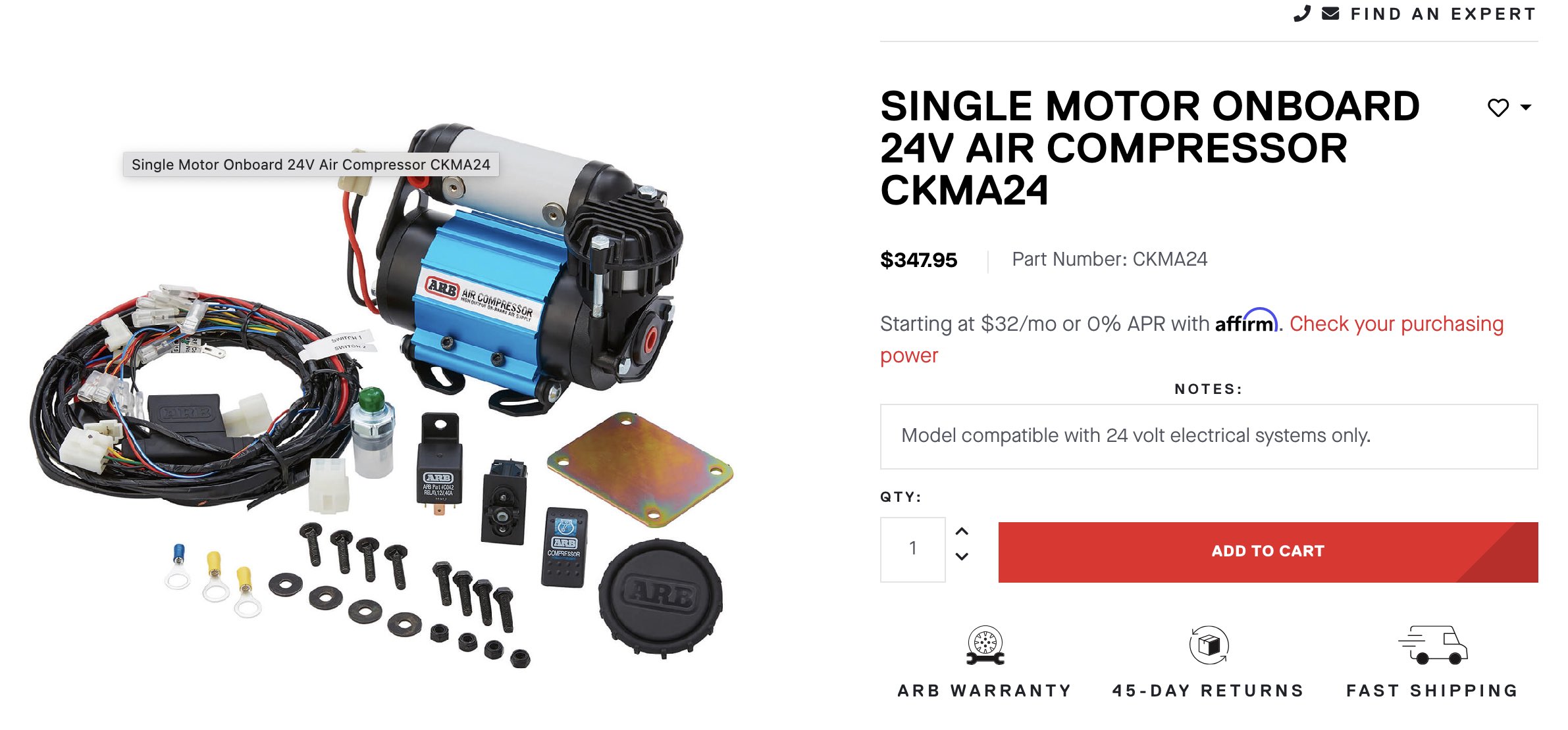

I have been assuming your doing a fresh install of a onboard 24V Single or Dual ARB compressor.
These come with a wiring harness (see attached). That harness includes a Bosch type relay and
an inline fuse that will provide power to the compressor WHEN then switch is turned on. I have
one installed in my 710K however, it is all powered off of my 12V auxiliary battery. The compressor
and the relay are both powered from 12V.
I have been assuming, and this may be incorrect that your installing a 24V onboard compressor
with all it's factory embellishments -- maybe your not? It sounds like there's already some bits
and pieces in place e.g.e #2 battery connection -- what's that exactly?
So before I go any further, can you tell us what ARB model this is and what may or may not be
in place already

Hello
I’m installing the twin motor 24 volt compressor. It has two looms. One goes to the batteries. It has two large red wires that connect to positive on the #2 battery, one large black wire that connects to negative on the #1 battery, and a small black wire with a 5 amp fuse that connects to negative on the #2 battery.
Then there is the switch loom. It has a red/yellow wire and a blue/white wire (diodes on each wire)that connect to a 24 volt source. It connects to the switch and connects to a long extension that connects to the compressor.
I was hoping to skip the arb switch. I was thinking that I could splice in the diode from the red/yellow wire to the long extension and use the switch for the pinzgauer power outlet socket.
I think the blue/white wire is just for the light in the switch.

OK, this helps a lot! Yes, you could set it up that way -- using the AUX power switch under the dash.
I did something similar. Just a suggestion, I also added a small Air tank as a reservoir to help buffer
the compressor.
