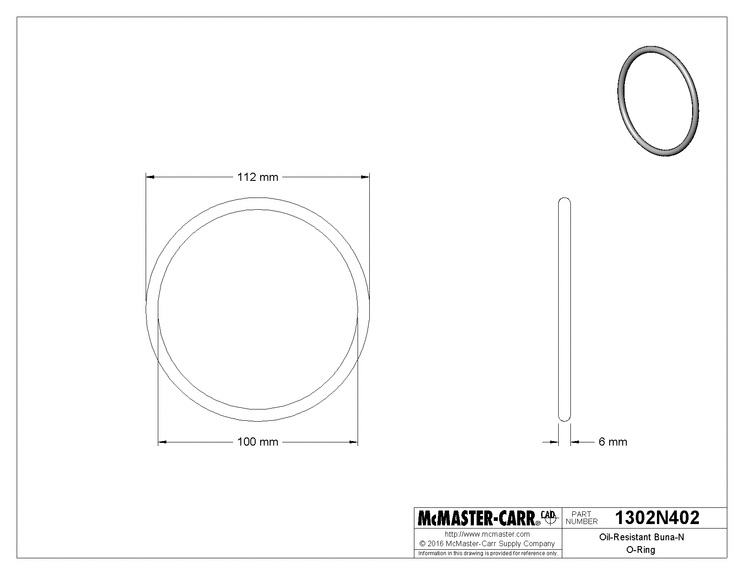

mcmaster.com has many, many o-rings, etc.
Maybe this: https://www.mcmaster.com/1302N402
1302n402_multipurpose o-ringl.jpg (38.29 KiB) Viewed 8614 times

I thought about going the O-ring route, but both the lens and the back of the tail lamp box have thin sharp ridges that are meant to dig into the flat gasket-- to be sure it seals, I suppose. Used gaskets have an obvious line where the ridge was (see attached)... so I think staying with a flat gasket would be best. I'd go O-ring if I can't find anything else, tho...

I don't think an o-ring is going to work well for the reasons already stated. I think it needs to be a flat squishy (low durometer) gasket.
