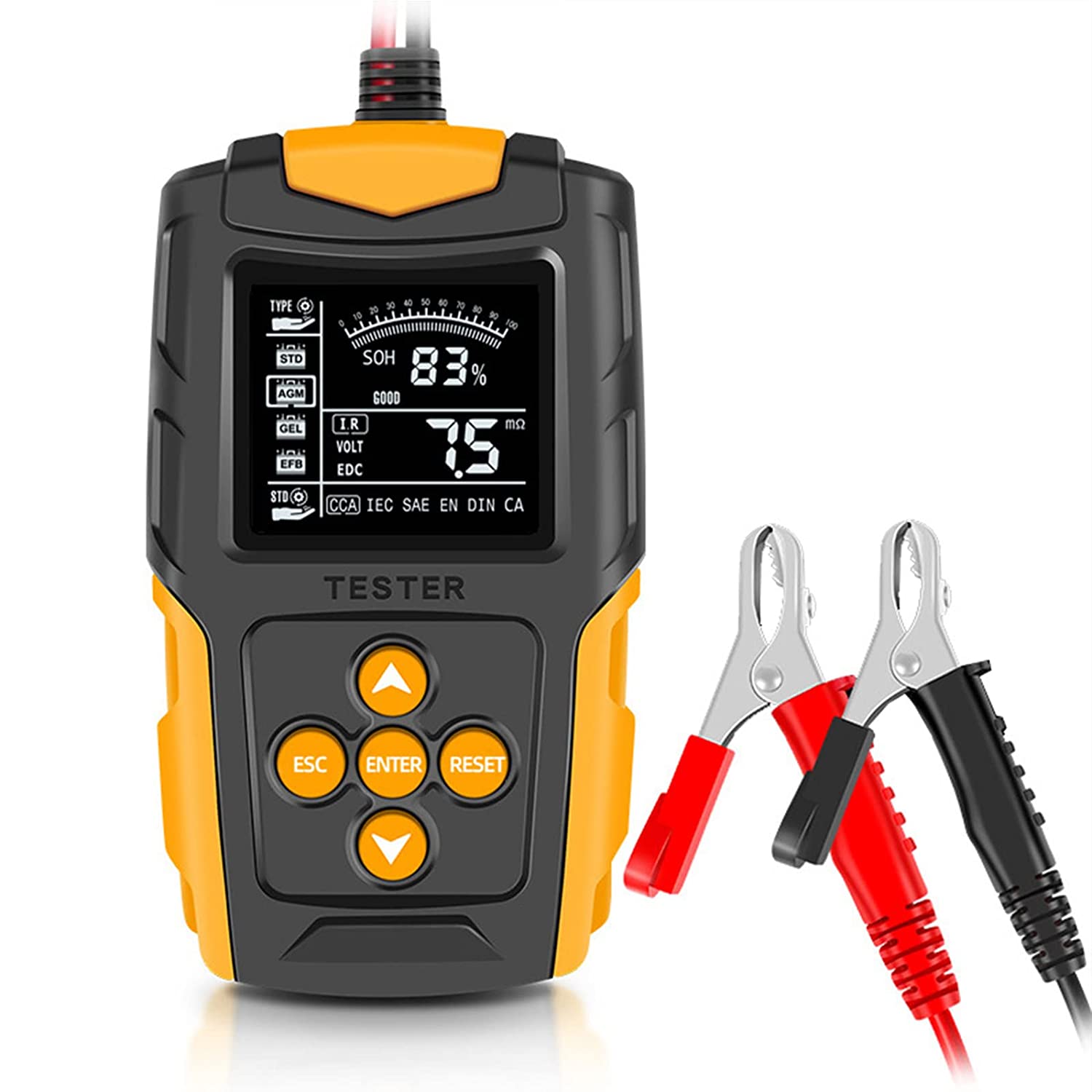

On a side note, I found a battery tester on Amazon that seems to work quite well for $33. I have several vehicles and tested the battery in every one, and this tester came back with accurate results. 3 batteries were bad, something I was already suspicious of. I charged the battery beforehand and then ran the test.
