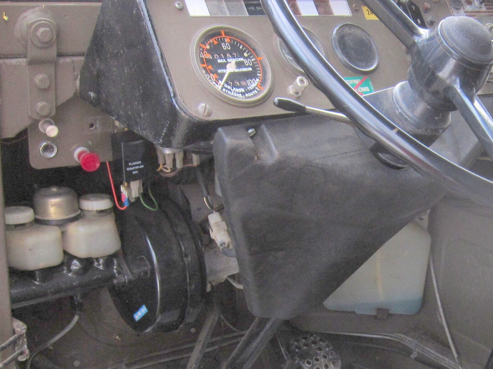

Re: Flasher Relay
Post by bbolander »
I managed to fit mine to the top hole, wasn't easy.
IMG_1656 copy.jpg (526.54 KiB) Viewed 4577 times
