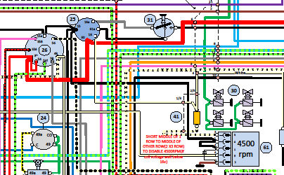

Here's a wild guess as to what is going on with the ignition switch and starter button. It may be way off since I haven't examined an ignition switch for continuity on the 'off' and 'on' positions.
1. When the ignition switch is moved to the 'on' position using the key, 24v is available at terminal 16a which goes to the starter push-button. Terminals 61a and 16 are connected together.
2. When the starter push-button is pushed two output terminals are energized, one going to the starter solenoid and the other going to the end of the ballast resistor that also connects to the coil through the suppressor. When the button is pushed, full bus voltage is applied to the coil. Under normal running conditions the 4500 RPM module supplies coil voltage to the coil through the ballast resistor.
A guess, as I've indicated. Someone who's delved into the wiring further than me may have a better explanation.
Item 25 is ignition (key) switch
Item 31 is starter push-button
Item 41 is ballast resistor
Item 61 is 4500 RPM module

I think that George is correct in his explanation. The ignition switch does complete multiple circuits since it also provides power to the various circuit breakers. It may be possible to dis-assemble it though I tried once and just made things worse.

Ignition switch(25) provide two set of contacts.When key is turn "on",the 28v from battery connected to the terminal 30 is provide to the terminal 15 and terminal 61a. Also at the same time a separate contact is made between terminal 16 and terminal 16a.
Upon pushing the starter button the 28v coming from the terminal 61a is connected to the starter relay ( motor) and to the terminal 16 that in turn is connected to 16a .
Terminal 16a is connected to the ballast resistor at the level off the coil/ballast.These 2 are in series.
Therefore the ballast resistor that normally receive the voltage through the 4500 rpm module is by-passed and the coil receive 28v. When the starter button is removed,no more 28v at coil/ballast connection and now the ballast is in series with the coil and 4500rpm module. The 4500rpm module has two function:
-monitor the rpm of the motor ,reduce voltage if exceeded
-provide voltage to the ballast ans coil.
It can be removed but a connection between the 2 central terminals need to be made to provide a 28v to the Ballast and coil.
alain

Read terminal 16 is connected to coil/ballast and 16a to starter button..

The ignition switch can be replace by a single SPST that will connect +28v (Term.30) to Term.15 and Term.61a ( Term61a and Term 15 wired together).
Ignition switch has 2 Term. 30 and 2 Term. 15. and there is a lot of connection there...
Term. 16 should be OPEN after motor running to have the resistor ballast in series with the coil, reducing the voltage at the coil level. The 4500rpm module provide the +28v to the Ballast and coil.
Starter switch can be replaced by a DPST with momentary connection,one connection between Term.61a and motor,the other between Term.61a and the wire going from Term.16 to ballast coil connection.

I am in the 'planning stage' of installing Jake Raby's EFI and need to analyze the electrical circuit and came upon this excellent explanation of the ignition-switch and starter-button. I added this 'simplified' drawing of the circuit, it shows the starter-button as in real life; no connection to any voltage until pressed.
However I cannot figure out why the original Pinz design team ever included this strange 16 and 16A connection, you could connect these two permanently; because:
- No voltage ever flows to 16A and 16, unless the starter-button is pressed (so no voltage (28V) bypasses the resistor)
- Upon starting: voltage flows from 61A through the button to 16A and 16 and bypasses the resistor(41) - straight to the suppressor.
- After running the engine: no voltage flows from 16 to the Suppressor(40) so no voltage is bypassing the resistor(41), because the starter-button is released
I am sure I am missing something, but don't know what. The only reason the team included the 16-16A connection, would have to do with: after you switch off the ignition and accidentally pressed the starter-button or something,
Can someone shed a light for me ?
Thanks and best regards
Jules

I agree with your analysis; 16/16A are not needed (they could be connected permanently). The only reason that might make sense as to why it is there is if it was originally expected to use a "standard" key switch with a cranking position instead of the separate cranking button. When someone decided to add the button, the starting position sections of the key switch were eliminated but they missed removing the ballast resistor bypass contacts. But that's just a guess.
