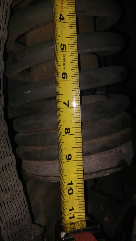

I have 9 coils and here is passenger vs drivers sides with the tape measure hanging from the upper flat top of the cup.
I added a 1 inch spacer that I need to shave 1/8 off of to bring mine level.
Re: Wheel well rub
Those are the front springs on your Pinz right -- which are indeed 9 turns each.
I'm on the trail end of this problem e.g. the rear double springs.
