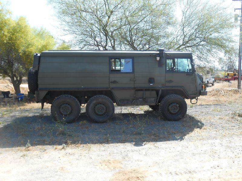

i have no idea, but is not that heavy,,, i just think they sag due to age....or the front spring are from a newer truck??? is my front end higher tan normal??? wondering

Re: raise the back of a 712......
A picture is worth a thousand words...
like David Dunn says... my front axle has positive camber, while my rear axles are almost zero camber or a Little positive but no negative camber at the back,,,,its 1 1/2 inch difference in height front to back.... :?: :?:
I would not touch the back.
Look under the front at the pin under the front springs, those are available in shorter lengths to level the ride.
Other choices are different (lighter) springs to bring the nose down , IF it really bothers you.
Personally, I'd throw the passengers that will be in it to see if the front settles a little more and see how it rides. Plus all the gear you'll be carrying. Ultimately, it how the truck performs and handles that matters.
I don't know how much and where your gear is, but moving heavier gear forward may help to put more weight on the front axle (but doubt it would be much).
I also just notice you have dual tanks, fill them both, that is more weight towards the front.
I think that you'll be liking new shocks over playing with the suspension. And if anyone notices the "nose up", tell them your Pinz is a proud girl and thinks she better than anyone else.
Very pretty truck.

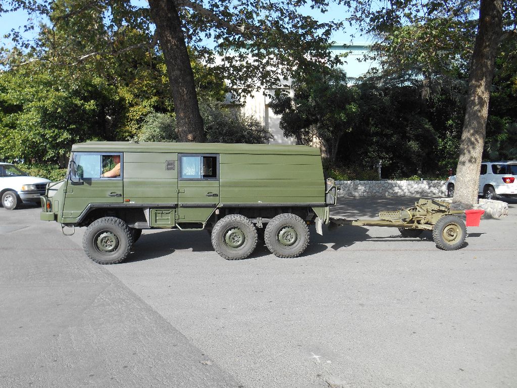

These are 2 pics of GG from the side.
In the first pic, the drawbar of the canon had very little weight on the pintle , and didn't change the rake of the truck.
And for some reason, in the 2nd pic, it looks "nose down".
Drive your truck and enjoy it.... no one can measure a 1 1/2" difference front to rear at 25mph.
