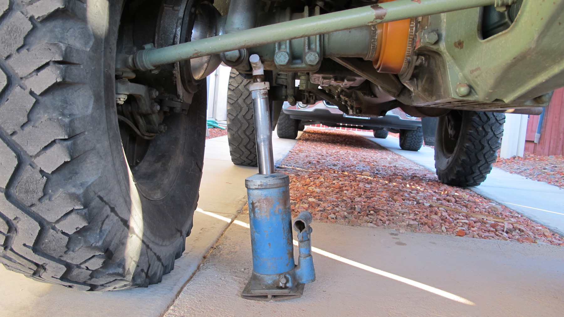

We've had our 71 710M for a few weeks now. The OEM jack has been behind the back seat with no leaks. I used it today to put one new tire on and it started leaking from the valve and a little around the base. I didn't get the jack handle with the vehicle so I used some pliers to close the valve, maybe I closed it too tight?
I absolutely love the OEM jack and want to fix it and have it with me in the Pinz to use.
Anyone fixed their OEM jack leaks? Suggestions on how to get parts required, etc.?

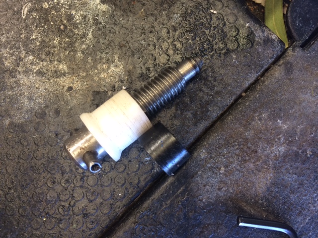

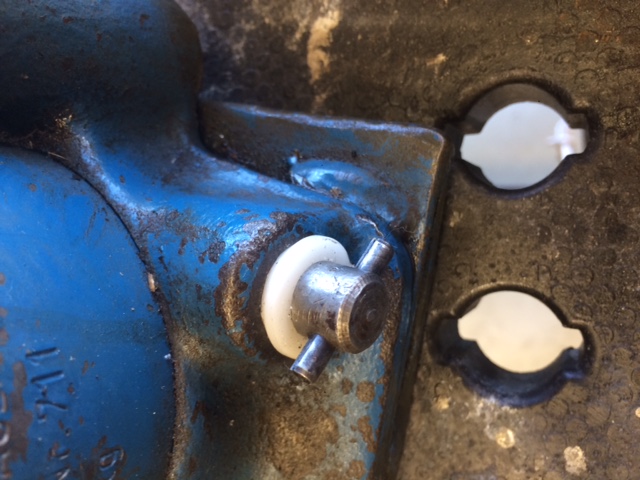

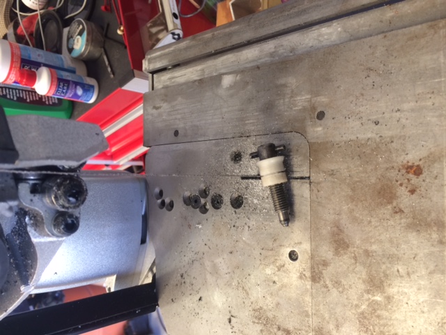

My jack was leaking from the valve that relieves pressure on the jack. Since that was the only leak I decided to try to fix it myself. I machined a piece of Delrin to fit over the valve stem which will compress rubber seal. So far no more leaks.
