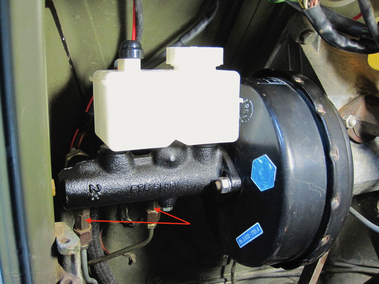

On one of the 710M's I bought years back, I had a similar problem with lack of braking in one circuit. It turned out that one of the Static Pressure Valves, part # 7103366220, had been installed backwards preventing the flow of brake fluid.
The attached photo has the 2 valves marked with arrows. Worth a look anyway.

Thanks a lot for the tip. I am hitting the trail to hike out of the jungle now to get a look and see what is up in there on that master. Man that would be so great if that is the issue. I do get some action to the rears if the pedal is pumped up so maybe that valve is an issue.. Or non existent. Thanks for the tip..

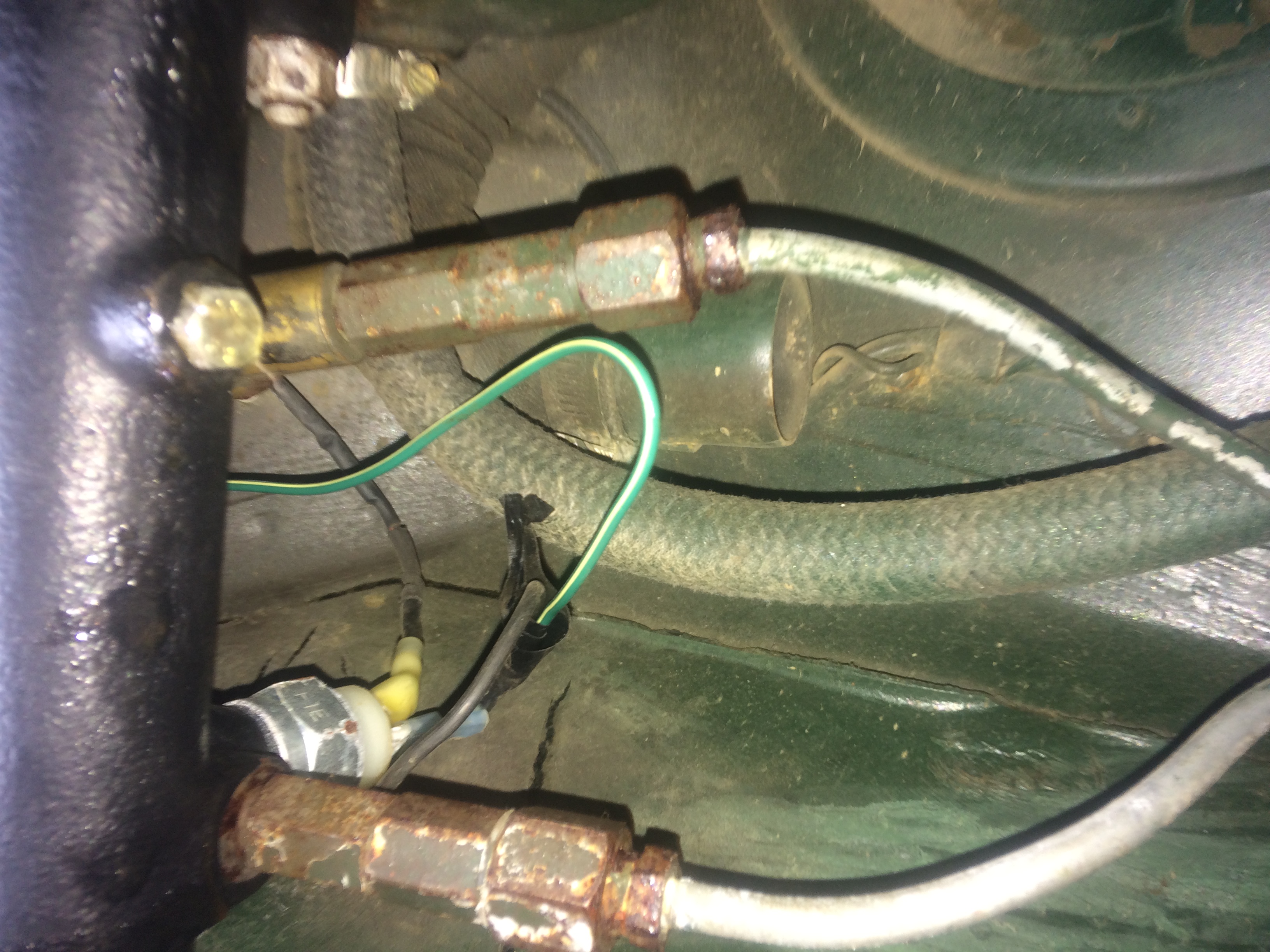

I finally got around to getting a photo of my master to see what I have for valves that might be wrong. Any way to tell which way they are supposed to go? And should there be two stacked on each line. Assuming that is what those are in the photo I attached. [attachment=0]IMG_3559.JPG[/attachment]

I took a pic of mine
looks quite identical

Re: Brake wizard needed in Costa Rica. Maybe I'll pay your way
Should we not first look at some basics:
The Pinzgauer is equipped with an ATE tandem brake cylinder that contains two pistons. When the brake pedal is depressed, the front piston (nearest to the booster), supplies fluid to the rear wheel cylinders and hydraulically depresses the rear piston to supply fluid to the front brakes.
Were a front brake pipe/hose to fail, the rear piston will bottom in the cylinder but the front piston will still supply fluid to the rear brakes. In the case of a rear pipe/hose failure, the front piston will bottom against the rear piston and mechanically depress it to supply fluid to the front brakes.
Brake drums have maximum diameter sizes for safety reasons and it makes sense to remove as little as possible. The relined shoes are then ground to a radius that is just smaller than that drum’s specific diameter. It is thus important that brake shoes are correctly paired with their drums if they do not all have the same diameter. Was the Jungle brake shop knowledgeable about this? Brake linings also come with different coefficients of friction thus have them all relined at the same time.
If all the above has been correctly done we should focus on the next point:
Modern brake systems have proportional valves so that the front brakes are actuated first to prevent skidding (lock-up). This is achieved by a valve that will only allow fluid to flow through above a certain pressure. Load sensing valves, on the rear body, do the same by varying the pressure allowed through to the rear brakes depending on the vehicle's load.
I had a look at the Austrian drawing that Albert supplied but did not clearly see valves however group 07-05 shows item 35 that I do not know what its function is as I only have the illustration without the legend. Pcolette earlier mentioned static pressure valves part # 7103366220 that had been installed backwards and preventing the flow of brake fluid.
Albert can you clarify what this is and why are there two of them as shown in your and Jungle Fever’s photos?
