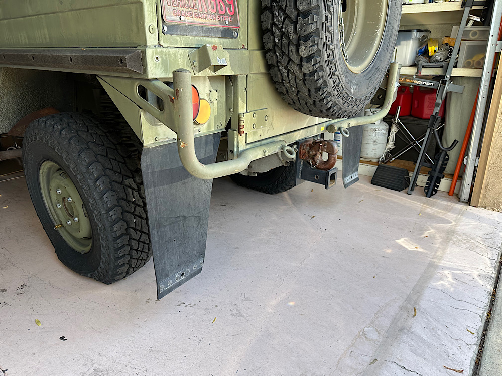

My empty truck lowers 2.5 inches from 40 psi down to 3. Measured at the bottom of my class 3 hitch receiver.
If I put a 4 ft level on my truck bed side it slopes downward to the rear 1/4 inch in the length of the 4 ft level at 40 psi. This about exactly matches the slope of my garage floor. So my pinz sets level on a level floor.
I am going to be removing my rear soft top soon I think. I’m confident I won’t have to air down at all.
I think the driveway approach angle matters when driving in.
Tires matter. I selected my 235/85r16 tires to assist me in getting my truck in my garage. Although by airing down any tires should work.
It’s obvious I don’t need to air down as much as I do…. So I’ll be adjusting that to save me work when airing back up.i only air down my back tires. I never have done the front. Even when backing into the garage.

That's fantastic thanks! That feels me that removing some trim plus deflators should solve my dilemma. I hate the hassle but if it's the difference btwn having a pinz and not it'll be worth it. Thank you for the details.
