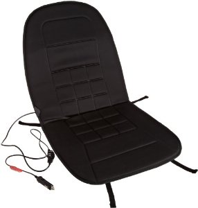

I recently picked up a couple of these to try out:
http://www.amazon.com/AmazonBasics-12-V ... at+cushion They are 12V so you would need a 24-12 convertor. They work pretty well - not a huge amount of heat but definitely helps.
Or you could go this route:
http://www.sportsimportsltd.com/24v-or- ... s-kit.html
They also have a lot of other options and 24V items.

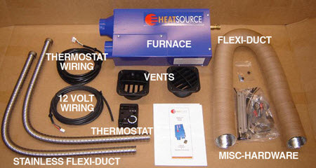

I have been looking at these (have no experience with them)
6500BTU 12.5 x 7 x 4" $780.00
http://store.adventuretrailers.com/prod ... S2000.html
9500BTU 16.5 x 8.5 x 5" $920.00
http://store.adventuretrailers.com/prod ... S2800.html

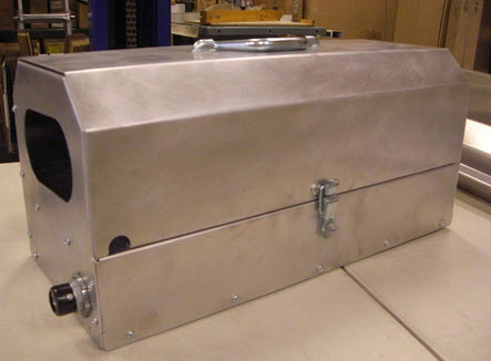

They made up a portable one (kit is really expensive) but you could easily build one out of a tool box
Would be handy to move it from Pinz to tent to storage in the summer
http://store.adventuretrailers.com/prod ... Y-Kit.html EDIT: just found a source that says they come in 24v too
2 models (note they are 12v and propane so you would have to carry a tank - I would just have a few of the small bottles and you need a 12v converter)6500BTU 12.5 x 7 x 4" $780.00

Those look interesting. Wonder what the run time is on a small propane bottle.
1973 Pinzgauer 712M
It's like being a celebrity driving this puppy around town. You can't go anywhere without someone stopping you or coming up to you to talk about it.
Re: 24VDC Heater OPtions
Consumption of propane running continuously:Pinzi73 wrote:Those look interesting. Wonder what the run time is on a small propane bottle.
HS2000 at 6483 BTU, 3.2 hours on 1 lb. of propane.
HS2800 at 9554 BTU, 2.0 hours on 1 lb. of propane
So if it is not at full heat and running off the thermostat you should be able to get roughly 9+ hours
