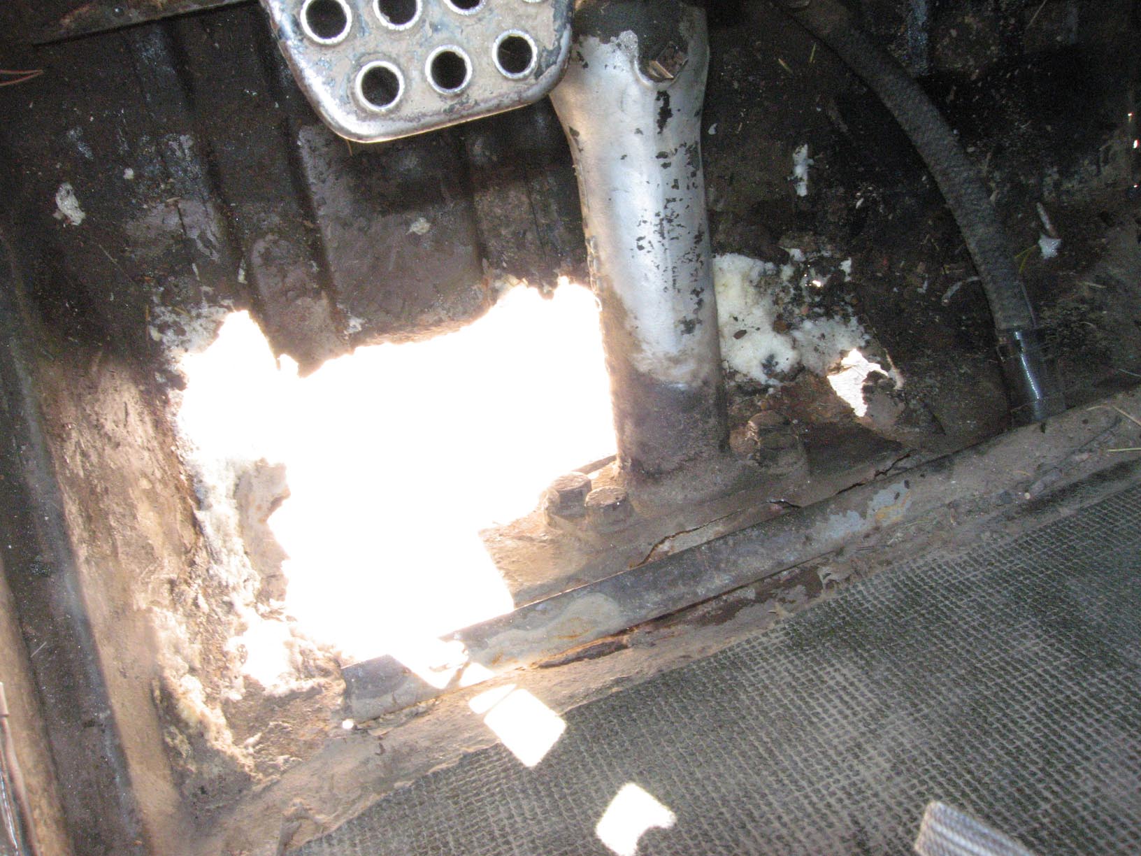

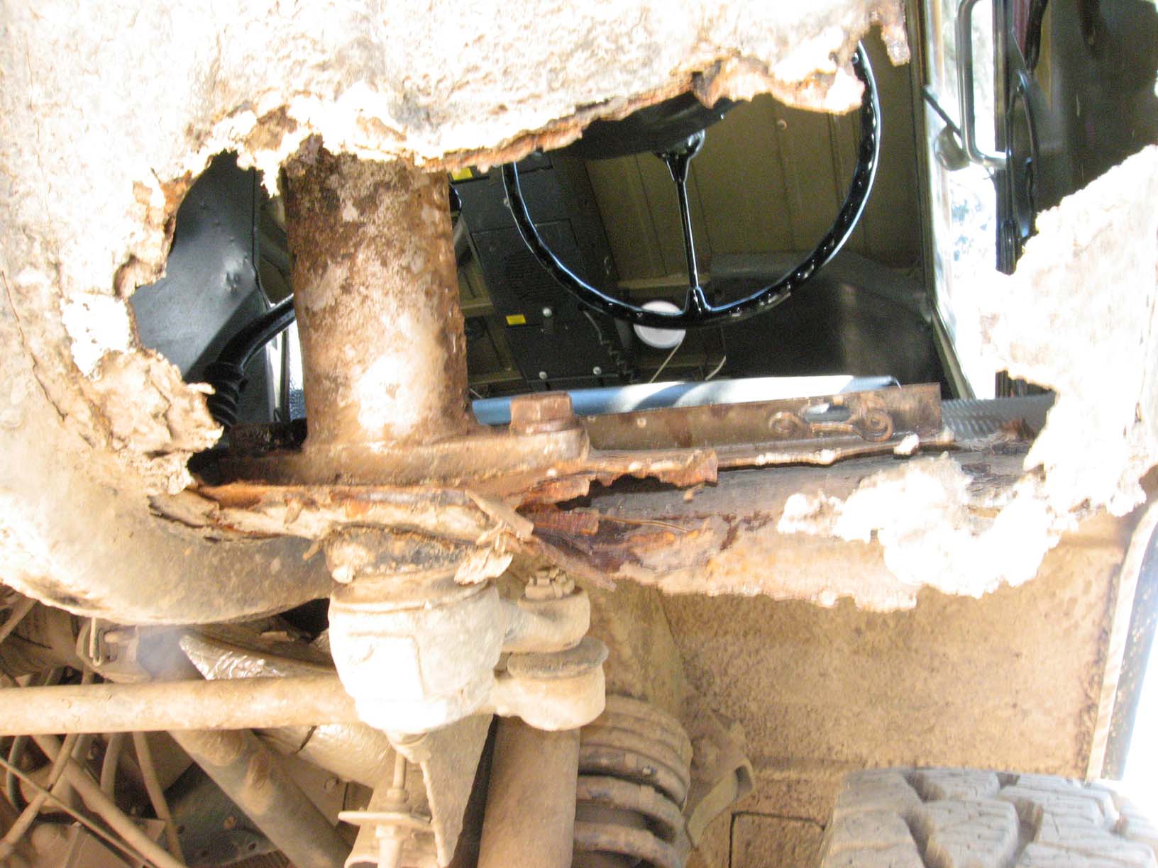

Re: Replacing front floor pan 710K?
I finally got it home. I pulled my expanding foam patch, and what was left of a prior owners failed patch. The floor is basically fully gone on drivers side. Even to the right of the steering shaft is gone, but the prior owner repair still holds. The steering column moves freely when you steer or hit a bump, the only thing that kept it from being worse is the foot plate slot.
Yeah, would have been deadly at any speed over 10-15mph. Oddly on the actual trail the real damage wasn't that noticeable and we were able to get back through some tricky situations. It sorta steers itself over rough terrain anyways or you risk losing an elbow into the door. I am sure this is going to break my bank and make my grandpa (the guy who left me the money to afford this toy) roll in the grave. But oh well, what is money for. Better to fix it right than do some bodge repair like what masked this problem to begin with. This is almost the only rust, thanks I think to the leaky driver window (they all leak!!), sitting a few years at the right angle pooling water. The passenger side is clean and solid.

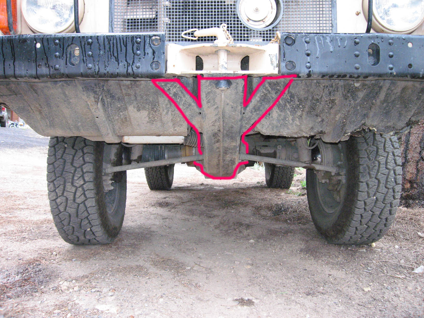

I didn't realize how complicated this floor is! I thought some of this stuff was below the floor meaning it would have to be replaced from above. But now it seems like the only thing other than the stuff that goes through the floor that hinders this from the bottom is the angled bit of chassis that comes up from the axle to the bumper. That looks like it would unbolt and then the whole floor could be pulled down?
You will have to remove all the steering links to get the nose support off.

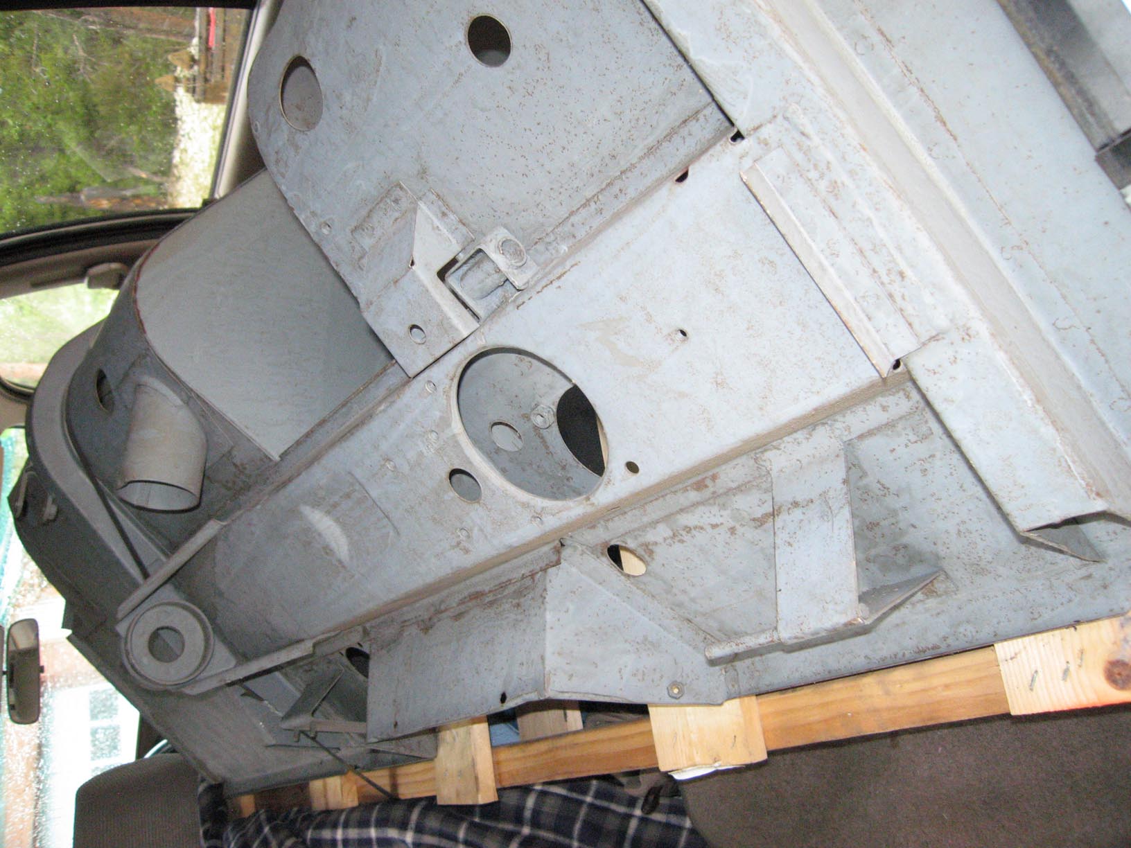

I have the spare part 16... it is quite a part, much more than just a floor! So I am trying to figure out how to install it whole because chopping it up seems a shame. It doesn't seem like you'd have to remove the body to get at this. The whole piece is forward of all the parts you mention. The only thing that seems in the way is the nose support.
Have a look at the picture
item 16 is the whole floor pan. The 4 bolts holding the steering assy are on that item
get it welded in properly, and your problem will be solved; tinkering around the steering mounting will lead to catastrophic failures !
