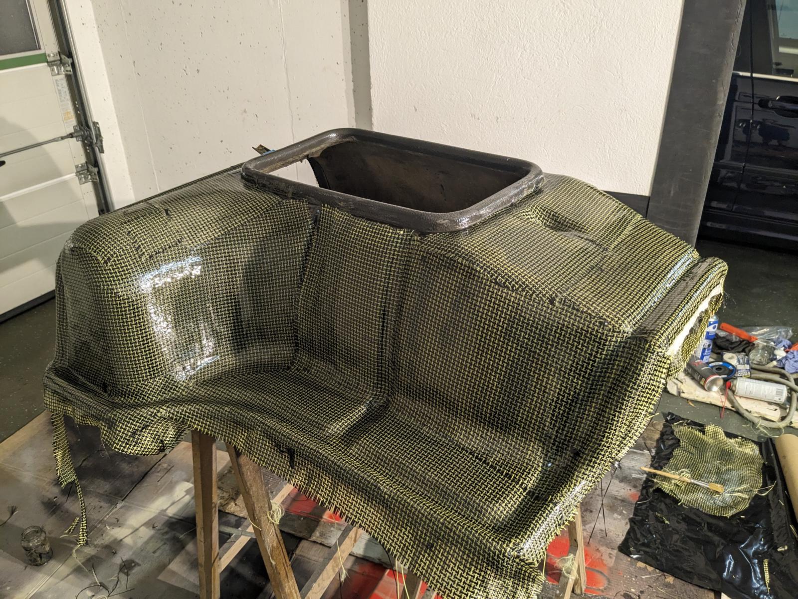

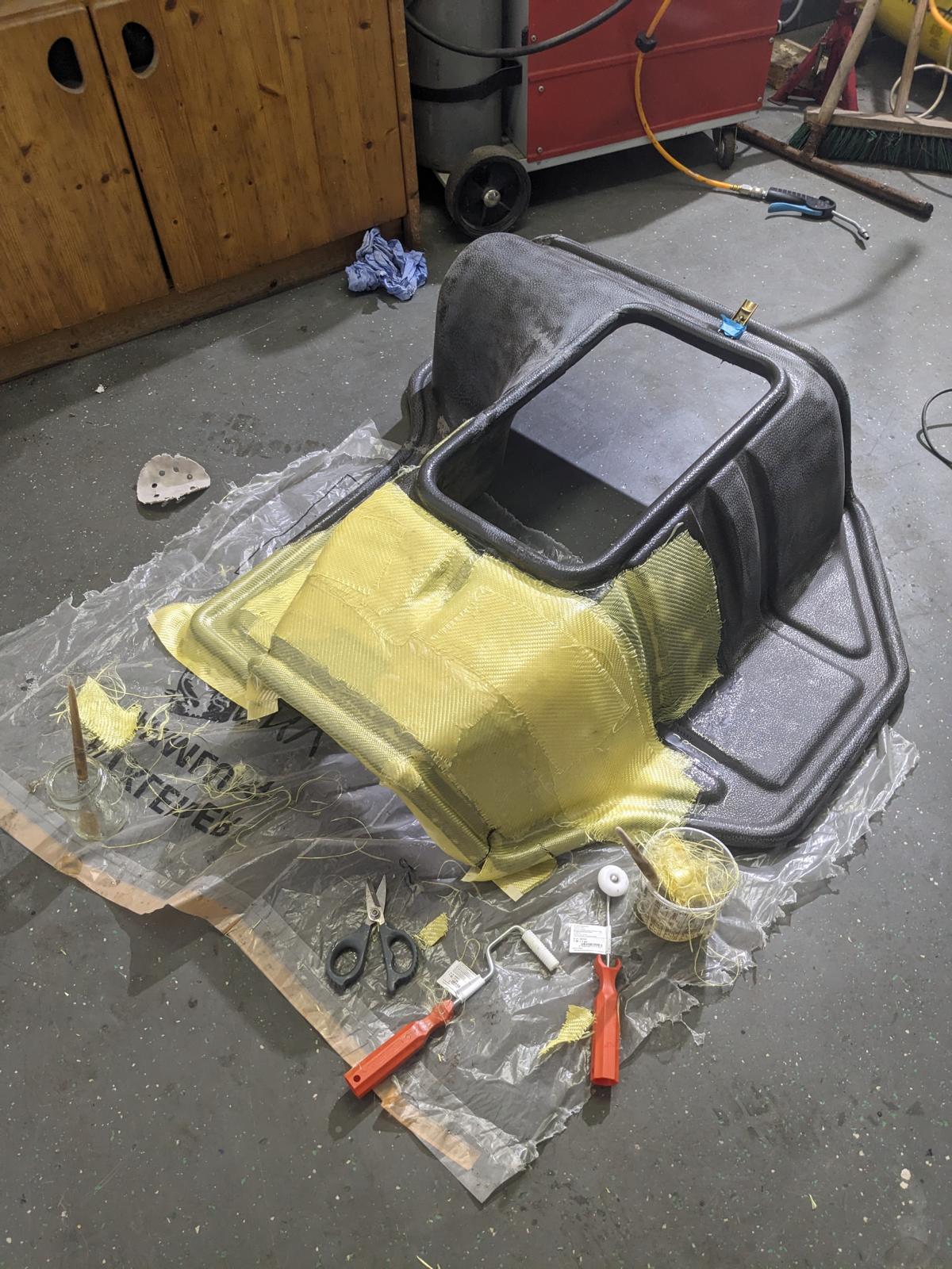

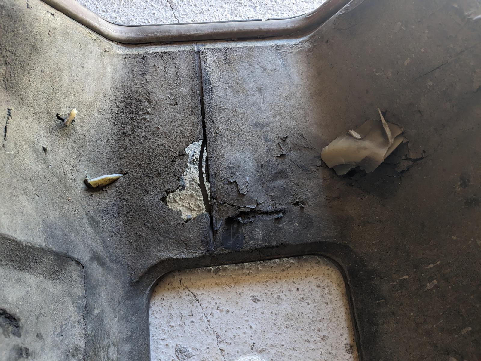

I've reinforced it with kevlar/armid and epoxy resin (my engine fan exploded and damaged the dog house)
"welded" the cracks: Repaired the holes with carbon/kevlar: 8-10 Layers of aramid/kevlar in the fan area:
Re: Dog House Cracked

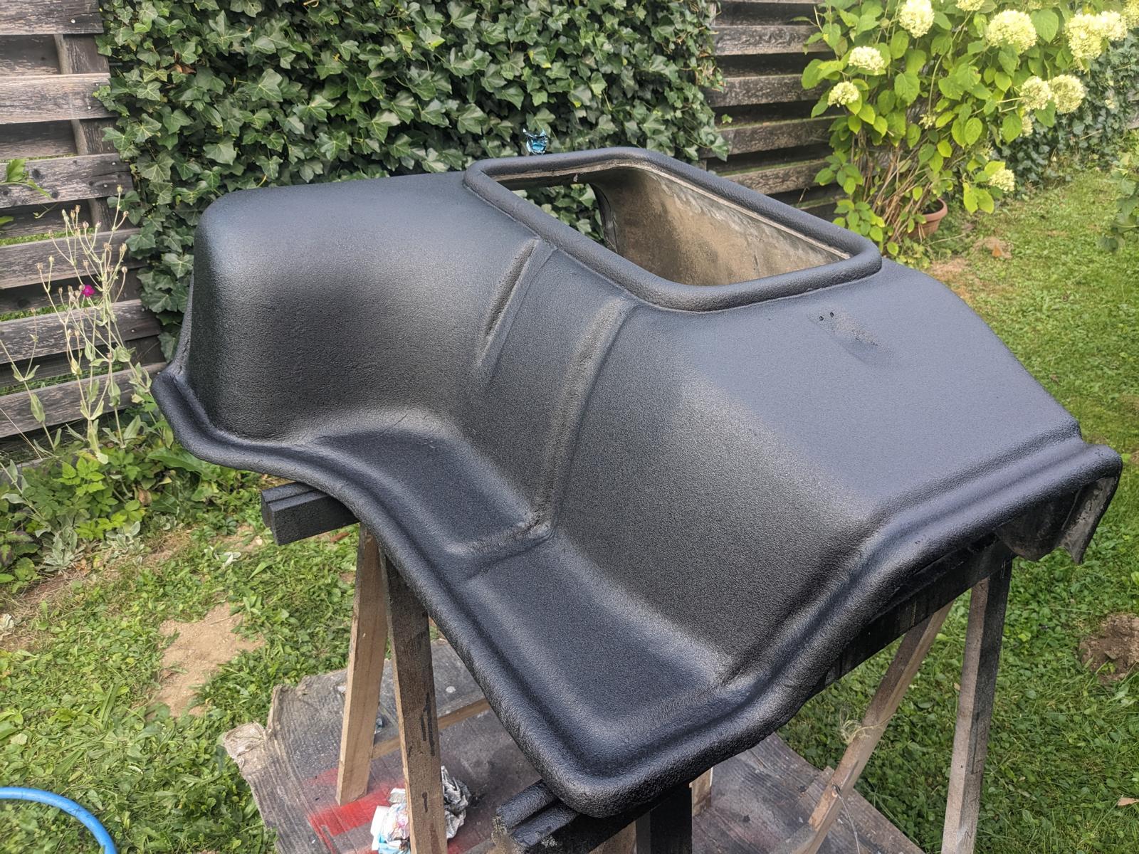

Another layer of carbon/kevlar for the whole dog house
Painted with Mipa Protector
Done
Nice side effect: It also reduces engine noise

I’m considering the Kevlar layers, but I have some questions.
What did you do to prep the surface?
How did you cut the material?
Are there any recommendations after having done it?
I only sanded the surface, no special treatment with primer.
I've used a Kevlar scissor to cut the raw fabric and a small angle grinder (Proxxon LHW 28547) to cut the excess on the dog house.

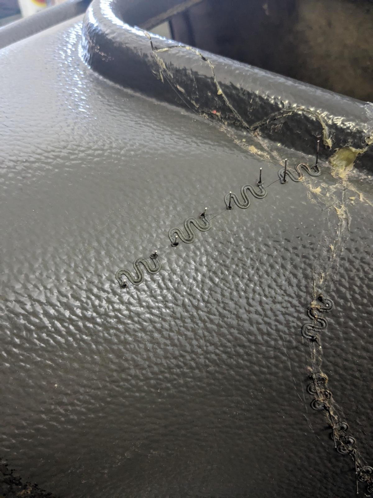

So my plan is to lay fiberglass this summer. In the meantime, I tried a plastic welding kit. The iron wasn’t hot enough to melt the engine cover. It took a lot of time and effort to get the wire mesh to lay flat. The end result wasn’t pretty, but since I was going to cover it with fiberglass, it didn’t matter. The kick in the nuts came when, while sitting in the sun, the whole thing let go along the edges. I was able to peel it right off with little effort.
So for those of you considering this to fix cracks in your engine cover… No.
