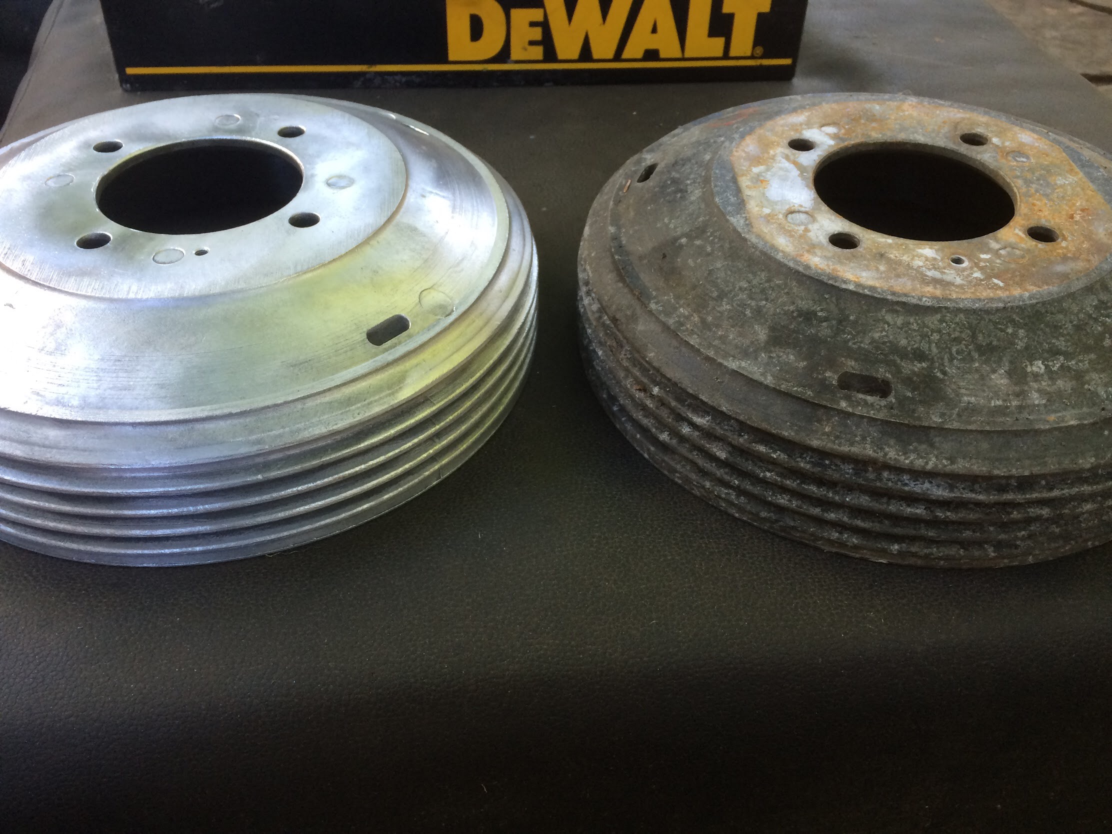

Haflinger parts:
Wire brush
Wire wheel
Before
After
Andre did my Pinz and used a similar manual process and finished with a very light coat of alum spray paint on the cast alum
