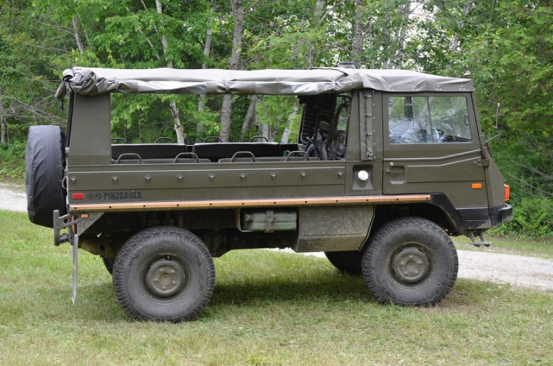

Re: rub rails
I finally have a photo of last summer's handy-work. The new rails are white oak with tung oil finish. The finish is perfect. If it starts to fade I just add more oil and wipe the excess of the next day. Screws are now stainless and missing trapped nuts have been replaced with hollow center rivets that have the correct metric tread already in them. Used a very cool kit I found in Ottawa at Princess Auto.
Added the black accents too.
Cheers, Clive
Cheers, Clive
- rails.png (906.85 KiB) Viewed 8197 times

Re: rub rails
tell me more of these rivets??
And how did you figure out where to drill the holes in the wood?

Re: rub rails
When I did mine I measured the spacing with a metric ruler than pulled a metric tap from first to last. They were evenly spaced at some thing round like 200 mm. I marked the wood and drilled it with a drill press with a machinist vice. I had to drill a few of them oversize when I fitted it but only a little bit. It was actually harder to find the center of the rail than the right longitudinal spacing.

Re: rub rails
Also known as riv-nuts, rivet nuts, etc.: http://www.mcmaster.com/#94020a383/=xxv5bj. Not sure if this is the correct size for the rub rails, but you can get the idea.tell me more of these rivets??
Re: rub rails
This is lighter version of mine but does the same thing.
http://www.princessauto.com/en/detail/4 ... -p2925204e
As said the holes are evenly spaced. A forstner bit took care of the counter sink. I used stainless machine screws and stainless washers too.
Cheers, Clive
Cheers, Clive

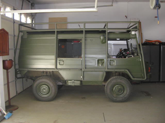

Re: rub rails
I beefed up mine and kept going.
I have the full set of original rub rails for the 710K, sanded and stained so the wood grain shows.
If your interested just PM me and we can work something out.
- Pinz cage 010.JPG (48.85 KiB) Viewed 8053 times
