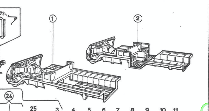

And just how are you going to fit the rear doors on a 710K on a 710M platform

Re: M to K
not an easy one if you want side doors
- screenshot_1846.png (189.07 KiB) Viewed 8184 times
