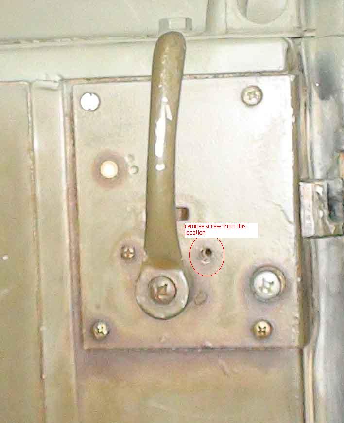

You also need to remove the “screw door lock” if your pinz has it http://www.pinzgauer.com/showdetails.ph ... o=9011957/ this screw is used to disable the door lock feature. Remember as Wolfgang already mentioned you cannot unlock from the outside if you do this modification and have used the inside handle to lock the door. I choose to leave my driver’s door alone as I know I would eventually lock myself out. The rear side doors on my 710k only required the removal of the screw. Less than 30 seconds to modify the rear locks, now I will have more peace of mind sleeping in back at a zombie infested campground.
Wolfgang thanks for the posting I couldn’t believe the engineer’s had not provided this feature.
Ed
crcpinz wrote: Ed, I also have a K and in reading your post I did not understand exactly which screw I'm supposed to remove to be able to lock the back side doors from the inside. I suppose it's a small phillips screw that I would have to drill out (all my door locks have that screw and others stripped), so I just wanted to make sure I pull the right one. Thank you for your time.
Javier
crcpinz asked for clarification so I have added a photo with the location of the removed screw circled in red. Hope this helps.
Ed

Amazing! I now have doors that can be closed from the inside. The mod was done with a Swiss army knife. Thank you Ed (and many others in this forum). You guys are an essential part of the reason I got a Pinz. Cheers to all.

Great tip, screws are now removed and I can lock the doors from the inside! Wish I'd known about this modification ages ago!
Thanks for the info.
