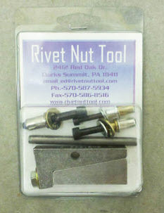

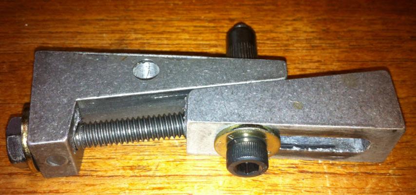

The following bits I used to replace rivnuts on my 710K (Austrian), and they pretty much match up to the hardware size previously installed.
I don't think the original rivnuts are stainless steel (looks to be aluminum to me), but I put stainless steel hardware to replace the originals.
McMaster Carr:
97467A666 18-8 Stainless Steel Heavy-Duty Rivet Nut, M6 X 1.00 Internal Thread (9mm OD)
93475A270 18-8 Stainless Steel Flat Washer, Metric DIN 125 M8 Screw Size, 16MM OD
92000A438 18-8 Stainless Steel Metric Pan Head Phillips Machine Screw, M6 Size, 30MM Length, 1MM Pitch
Rivet Nut Tool (6mm) about $18
The tool works great to set rivnuts, less than 1 minute per rivnut. Small enough to fit even a trail kit, does other size rivnuts too.
