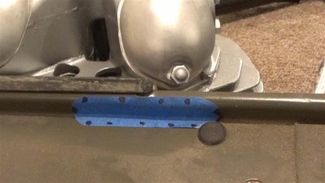

Here's the images of the crack in the pan. My thought was to weld/tack/epoxy a thin strip of angle iron along the inner lip. It occurs where the rolled slider edge stops. Probably something they fixed in the diesels?

Method A, Drill a small hole though the end of the crack. Clean the crack and surrounding area. Weld the crack shut. Cut a small piece of metal that would cover the area shown with the blue tape, bend to match seat pan contours alternatively use a narrower plate that would not need the bend. Use small welds such as indicated by the black dots. Clean, prime and paint, insure that the primer has a chance to soak in under the doubler to prevent rust.
Method B, If you choose to you could stop drill the hole then use JB Weld to attach the doubler and hope it holds.
I think the welded repair would last the life of the truck the JB Weld repair may last however I wouldn’t bet my butt on it.
