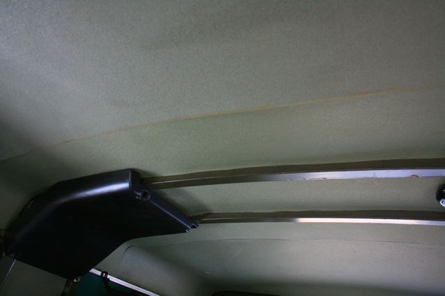

I have lined my truck with closed cell foam insulation and leave the vents (holes for cables) open to air the truck. Seems to work quite well although I get a puddle on the floor from leaking windows after heavy rain, but there is never much condensation anywhere.
