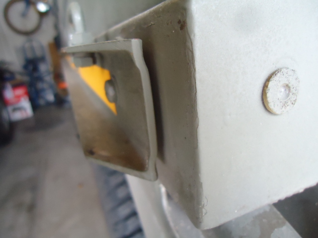

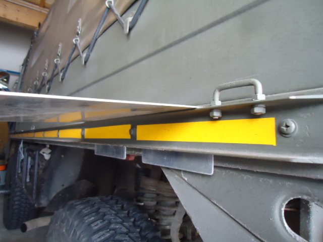

I made mine from metal channel 3/4 x 1 1/2
The wood got sacrificed years ago on some very unforgiving rocks.
