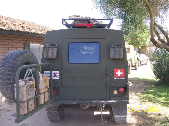

I just make baskets out of 3/4 x 1/4 flat steel. As you can see I make them in different sizes depending on the need. I even use the same design for battery holders on other projects. I even incorporated it into a spare can carrier that hangs on the rear tire for when I want a little more fuel/water.

Any issues with added weight on the rear door? I do see your door has been reinforced.

Mine are on the inside. I had brackets made and mounted them between the windows on the left and right side. One for water and one for petrol.

I have actually removed weight from the rear door (lesson learned in my jeep days). The rear bumper and swing assembly is a result of wanting to get the tire off rear door and provide a place for water storage without taking up precious interior room. To door top is something I made when I enclosed my 712M, mocked up after a K's rear upper. The rear door swings and shuts better than ever before.

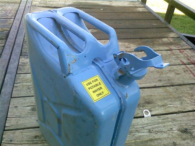

Re: Plastic Jerry Can
so the manufacturer miss marked this one and miss stamped it on the side?????
