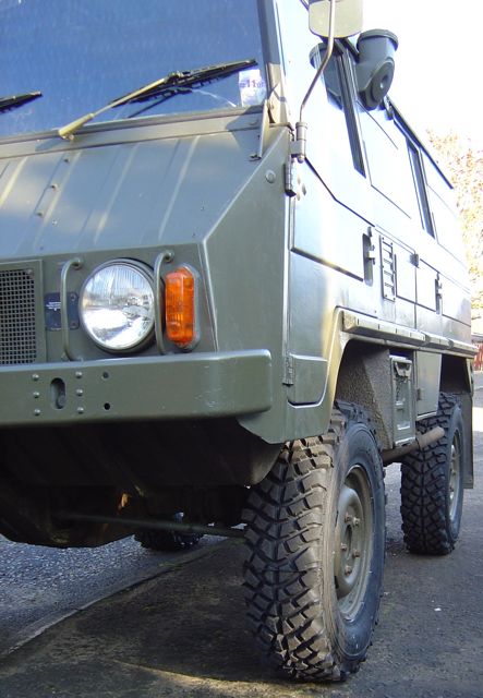

I run tubeless radials on original rims no problem.
http://www.flickr.com/photos/85306730@N00/1516092894/
- DSC03587.jpg (56.41 KiB) Viewed 4945 times

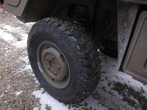

My Pinz is also running 235/85R16 but Cooper STT's
Thanks!
ScottishPinz your photo is great in comparing original size vs 235/85R16 so I am posting it here vs a link!Thanks!
