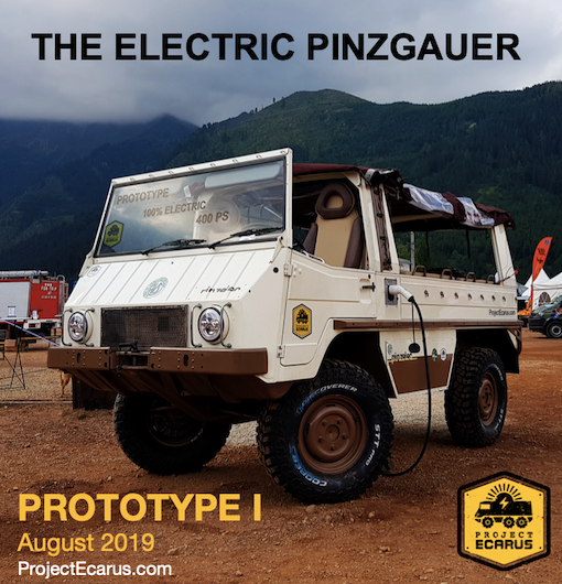

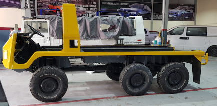

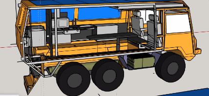

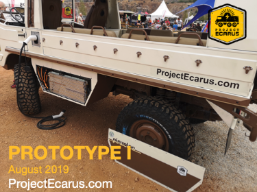

If all goes to plan, there will be conversion kits and full E-Pinzgauers (710 and 712 base vehicles) - with and without the solar option - we hope this crazy idea will work out - we will do a major overland test expedition over 7000kms. I'm attaching some pics here of our 1st protoype and some working designs, and if people here at real 4x4 are interested, we would be happy to share more project details here on this forum. (Note there are two vehicles on the pics - there's a 712 6x6 which we call ECARUS which is the main vehicle and a 710 (4x4) which is the Prototype, which we are using to test the electric Motor, Battery and Management system. This helps us make sure the Kit will work seamslessly to "plug and play" into other Pinzis, and allows us to develop in parallel ECARUS' expedition cabin and foldable solar system.

Thanks for the post. I'm very curious about the project as obviously this will be a needed solution in the future to keep all old cars on the roads.
The big question I have about this and some other projects claiming similar plans, is the solar aspect of it. I love what you are doing but I don't understand that part of it since it would be impossible with today's tech to even get close to charging up the massive power needs of an electric auto without massive panels that are many times the size of a 712's roof, and lots of time, not to mention lots of direct sunlight. I know someone here in Ca. who has a home solar system in his yard using high-tech, commercial grade panels that cost over $50,000 and it takes up quite a bit of room. I don't think even that would charge an electric car in a practical sense since you'd have to be parked all through the day (and hope it's not full of clouds) which is when you want to be driving. How do you plan to do it with even less real estate?

Thanks Vince, you hit the nail on the head exactly - the solar challenge is amongst the biggest ones on the project - since as you say, the few panels you'll fit ON a 712 won't get us far! So we have developed a solar system design that makes a massive 13Kw Solar System portable and flexibly deployable when you are parked, but fits into the pinz weight and size wise when rolling.
Our ambition and hence the system size is to recharge the 85KWh battery pack in one single (sunny) day.
There's just over 1 Kw permanently exposed (roof and one side) for a nice trickle charge and auxiliary power, and ca. 12Kw fold out when you set up camp.
Assembling this design, testing and integrating it with other charging/BMS software is the challenge we embark on in the next 6 weeks - our shipment of panels arrives Monday - wish us luck!
And yes, we'll have to select our wild camp sites accordingly for natural "real estate" that can be borrowed to be a chunky solar plant
