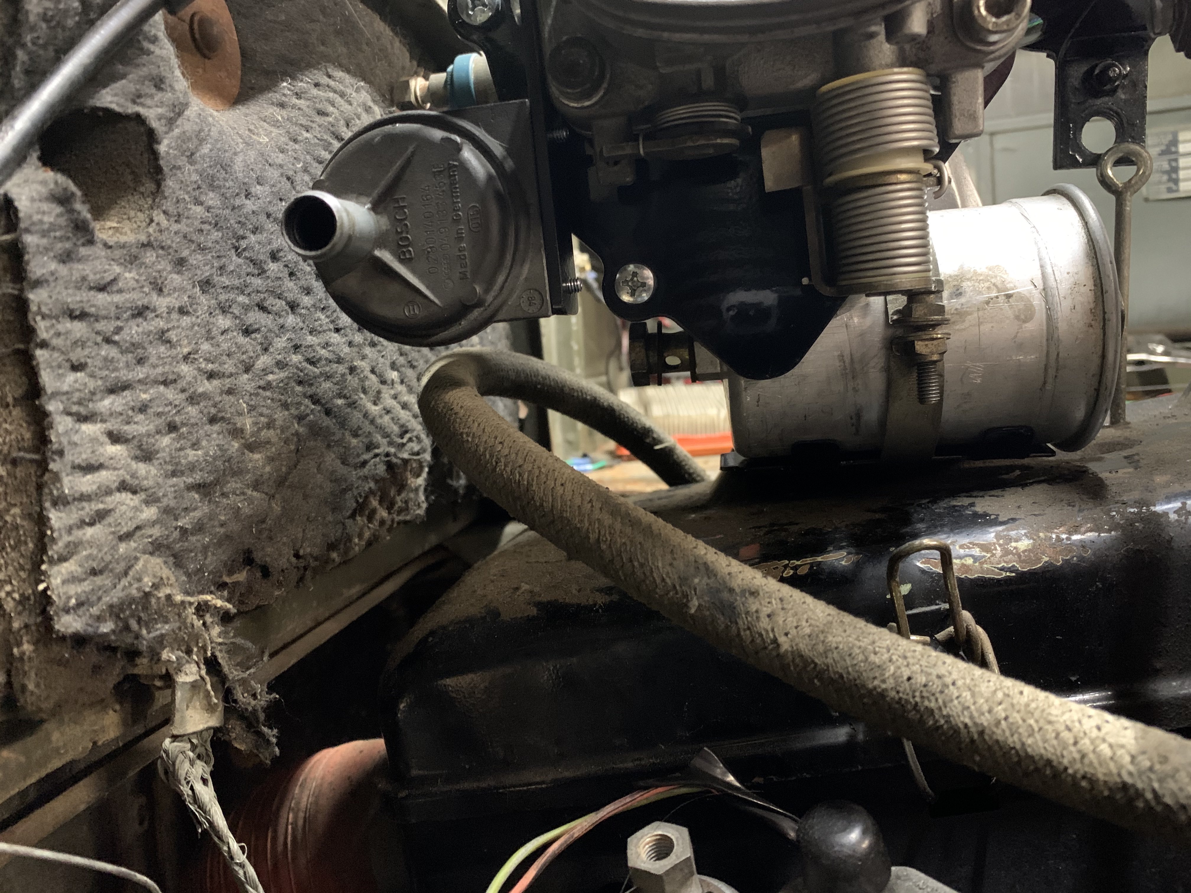

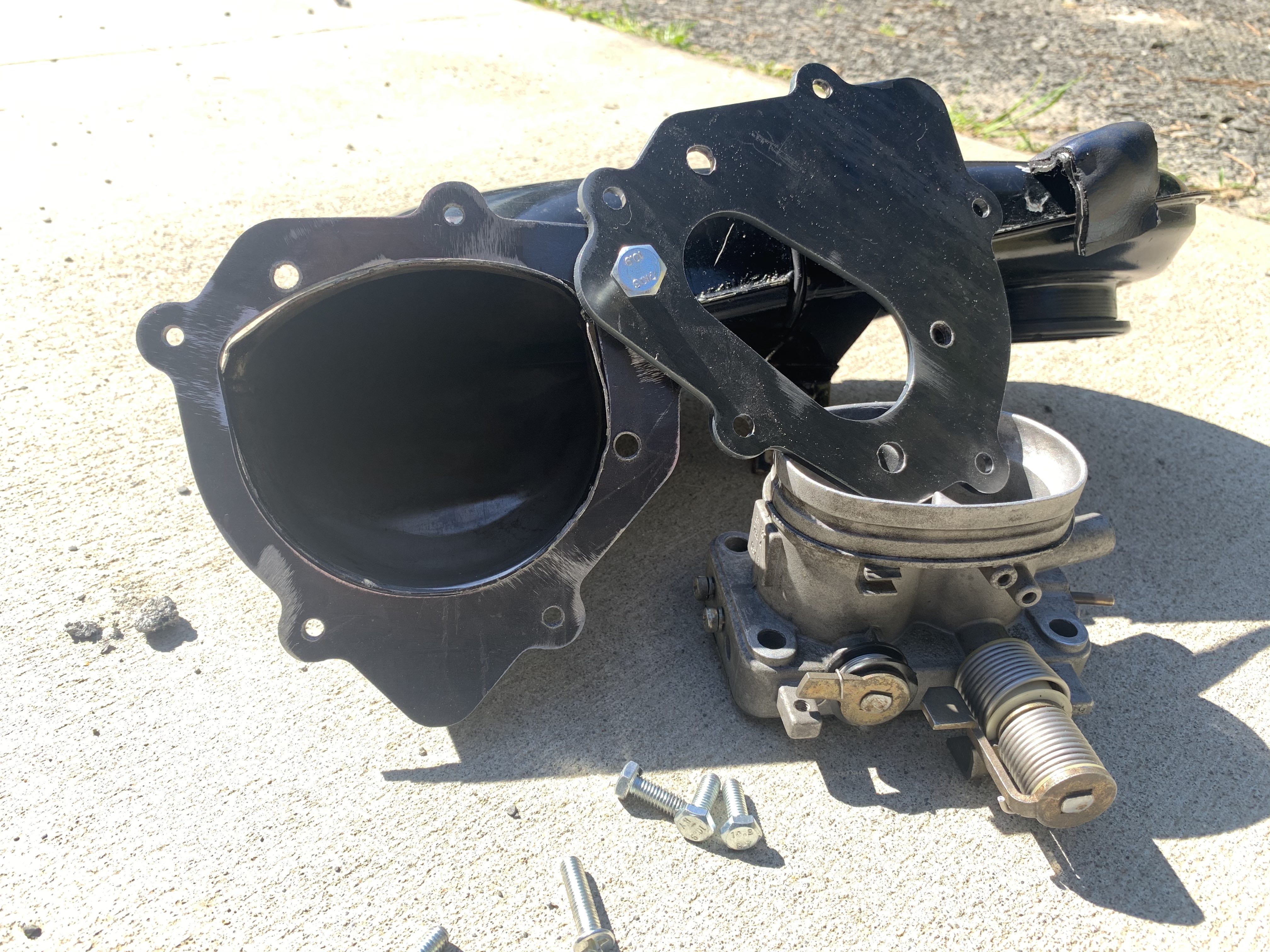

During the initial run test I discovered two very important issues. Too long of an assembly to waste space with a pretty TB adapter if it is to fit under the engine cover and even if it did fit, that rubber boot is hilariously too weak under full vac! So next idea.. build an ultra short one from steel. Downside is there's zero flex in the joint meaning the entire assembly needs to be hard mounted to the engine assembly and still clear the cover with engine movement under load. I did a test fit today and with the fuel filter relocated everything seems to fit. Heres pics of the flanges.BTW if anybody goes to make one of these the intake housing is rotated 10deg back. Never noticed that before.

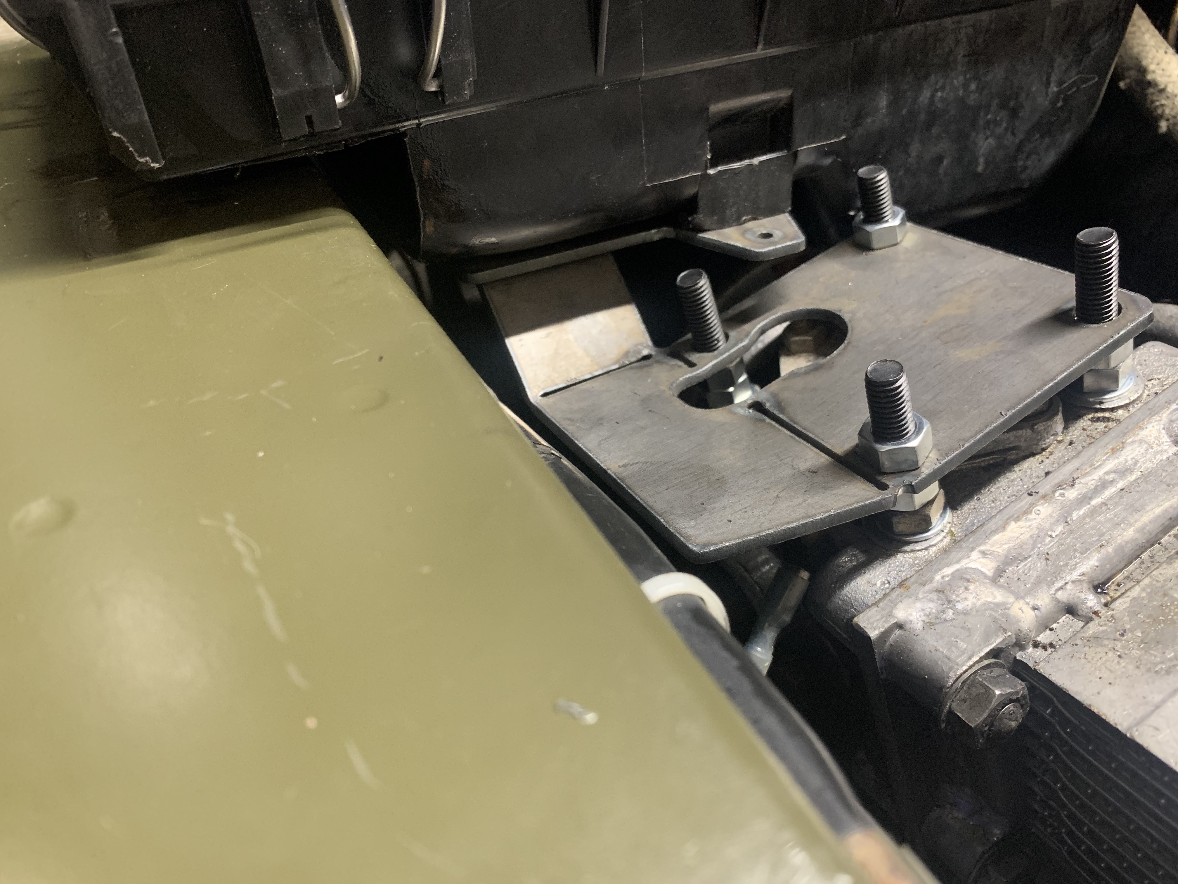

I was able to score a CNC plasma table a few weekends ago in trade, so yay! Not currently having income and ultra long shipping times is proving to make me think harder about how I go about this for sure! Stupid Covid. This week I made some progress on bracketry. I ordered some longer studs and made up the gaskets to R&R the oil cooler too. One issue I would like some input on is how much the engine twists under full load. I've owned this thing for 8 years and never bothered to watch the engine twist while driving. Now I can't do that until it runs again. If anybody can take a video I would really appreciate it. The airbox needed trimming to clear the body. Its close, like 13mm close to the sheet metal and it makes me nervous. Besides that it fits great and will be easy to plastic weld back together. Anyway, here's progress pics.....

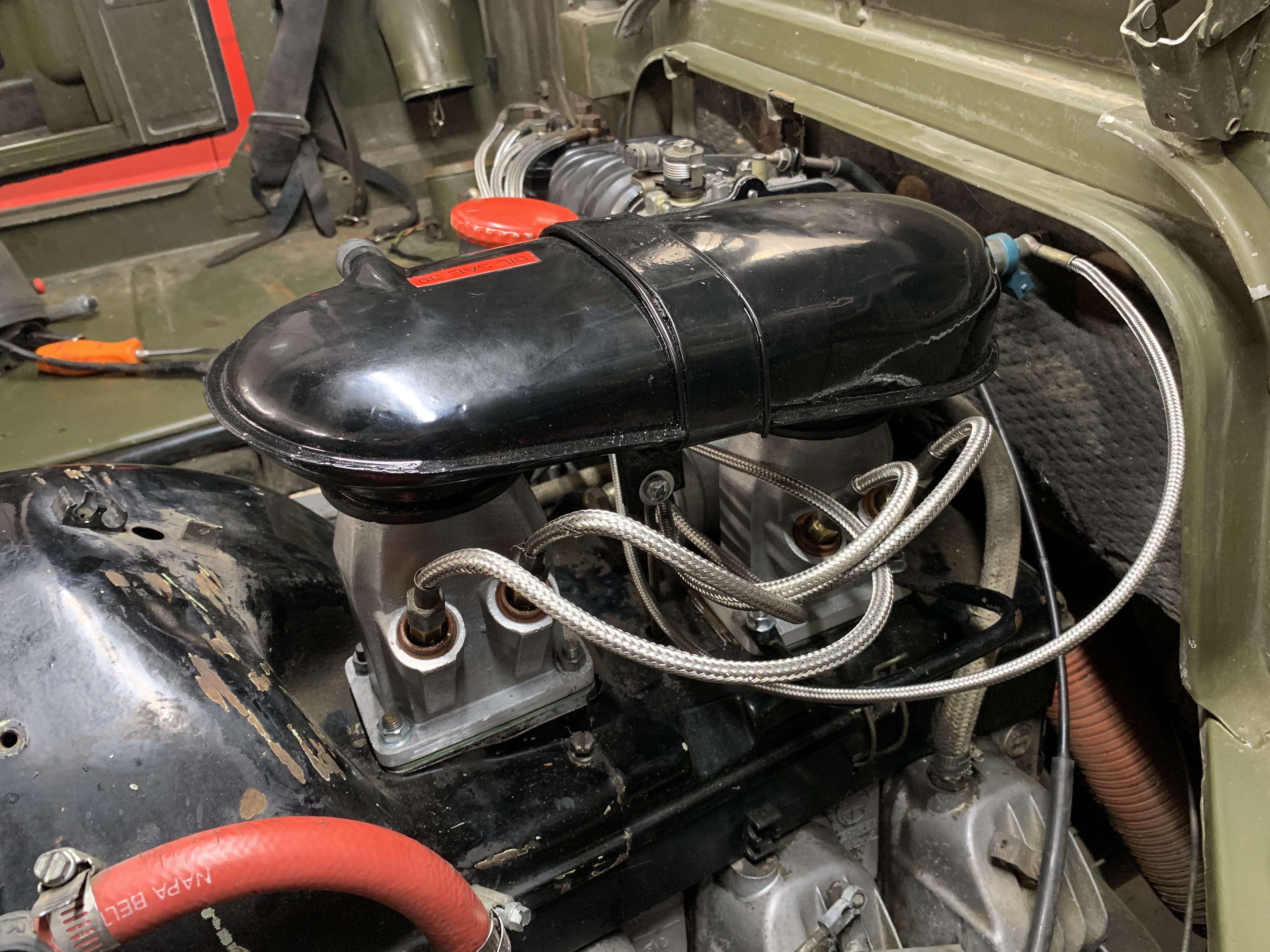

I made some changes to the airbox bracket for small allignment fixes and redesigned it as a single piece for easier reproduction. Made a flange for the cold start injector and brazed into the best location I could find. Aux air valve was going to be ported at the throttle body flange but after a test fit I realized it needed to be relocated so there's a task for the morning. The temp/time switch is usually in the radiator. After failing to come up with a good way to integrate with the oil cooler I thought why not use the fuel pump plate? If the goal is to stick the sensor where engine heat can be read then this should work fine? The warm up regulator needs to ne near an engine block so the fuel pump mount is now serving two jobs. Originally I was only going to use the fuel pump plate as a mounting stud. This is better.

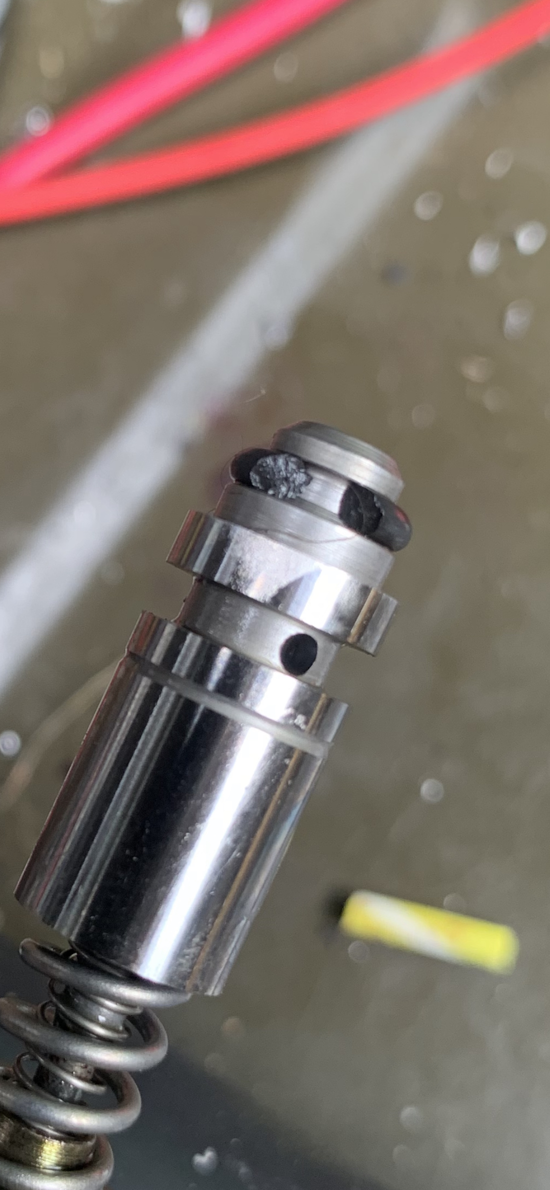

I was trying to solve a big flat spot right off idle the other day. It runs great besides acting like a carb without an accelerator pump. I was able to drive it around my yard even but its not steet ready yet. The fuel pressure test results were close to perfect and I was starting to doubt the projects success when I found this. I assumed using parts from 1979 would cause issues. A rebuild kit for the fuel distributor is on order. Till next week,....
