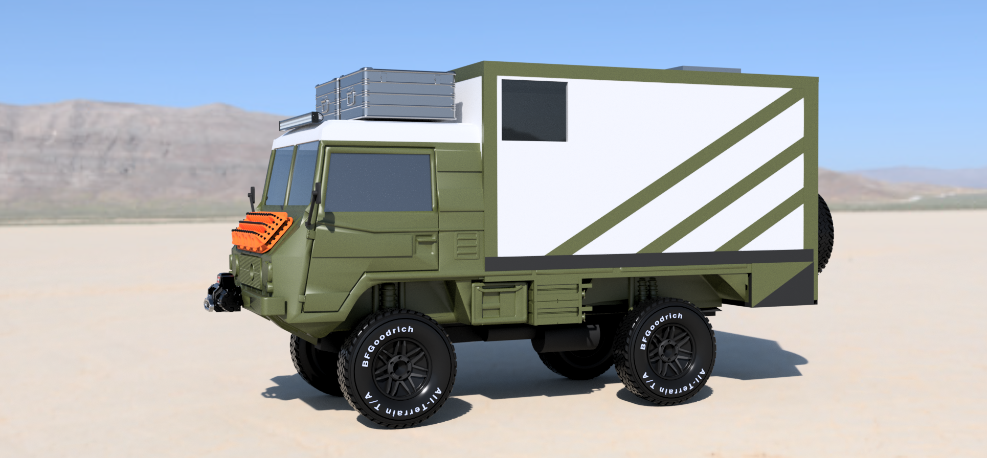

Below is a rendering of the finished project.

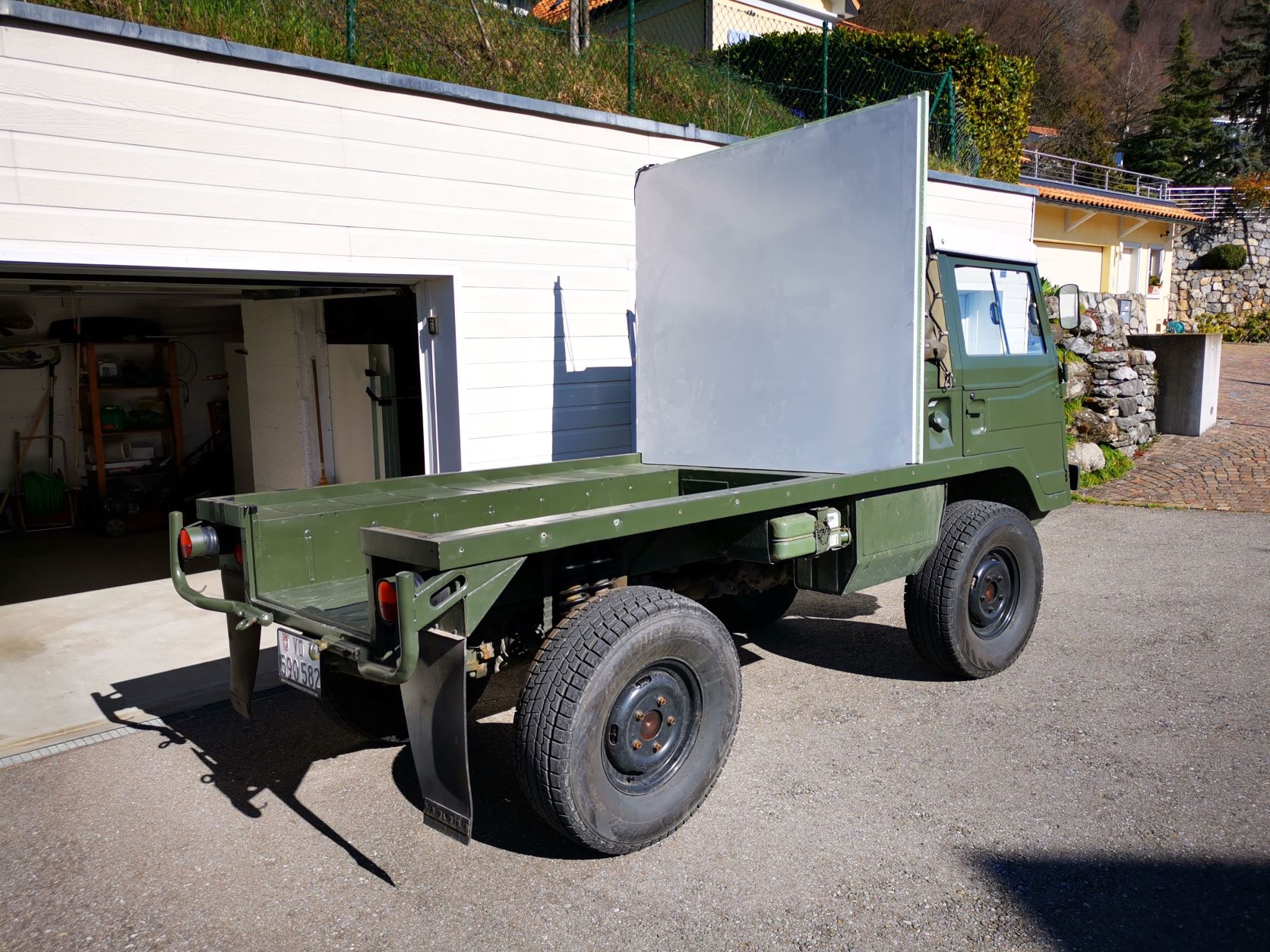

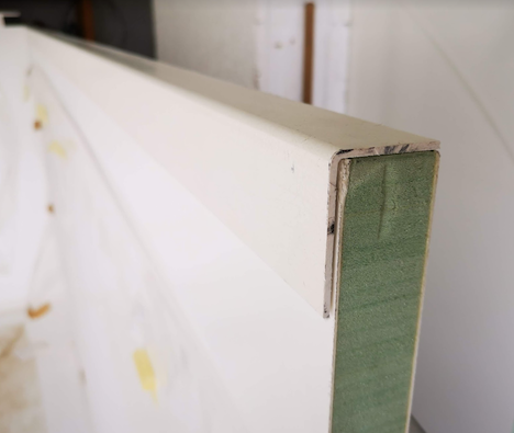

Here I explain how I will build the box and "connect" it to the frame of the Pinzgauer.
I will be using PET foam panels with fiberglass sheets on both sides, manufactured by https://coratec.ch/en/applications/wohn ... eisemobile
The 5 panels will be quite light, only 69 kgs, they are strong enough, no need to build a supporting frame.
The rear panel will be fixed on a metal structure that I will attach to the rear of the frame, and will serve as an extension to provide a bit more volume.
I welcome your constructive feed-back.

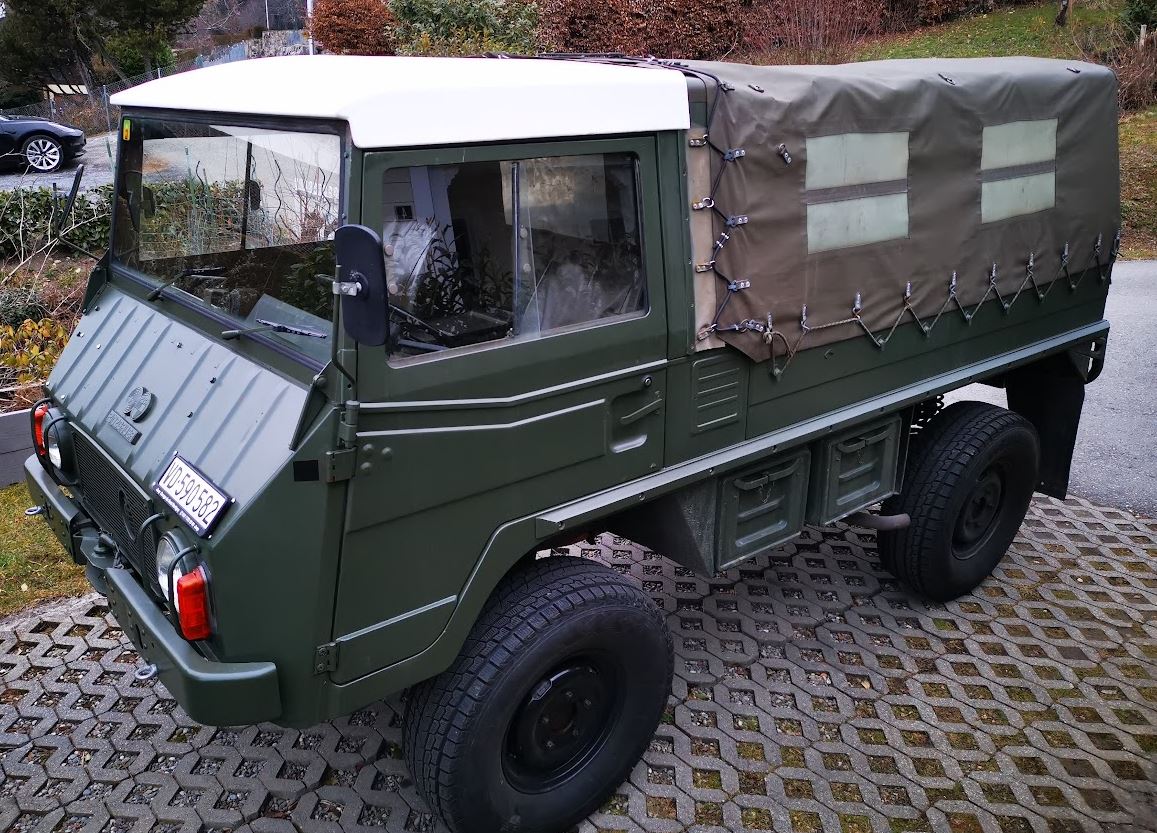

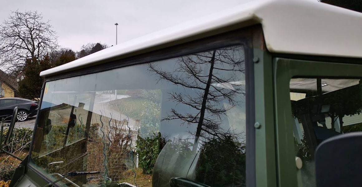

Test fitted my new hardtop today,
It's rather easy to install, there is a lip up front that catches the metal hook where the tarp straps in.
Then you drill on each side at the back to bolt it to the B pillar.
I still have to find a way to mate the hardtop to my box, to avoid water ingress.
I managed to keep the central U bar, so that it can support the weight of my storage boxes on the roof.
It weighs 11 kgs, but you remove about 5 kgs with the tarp and hardware, so net weight increase is 6 kgs.

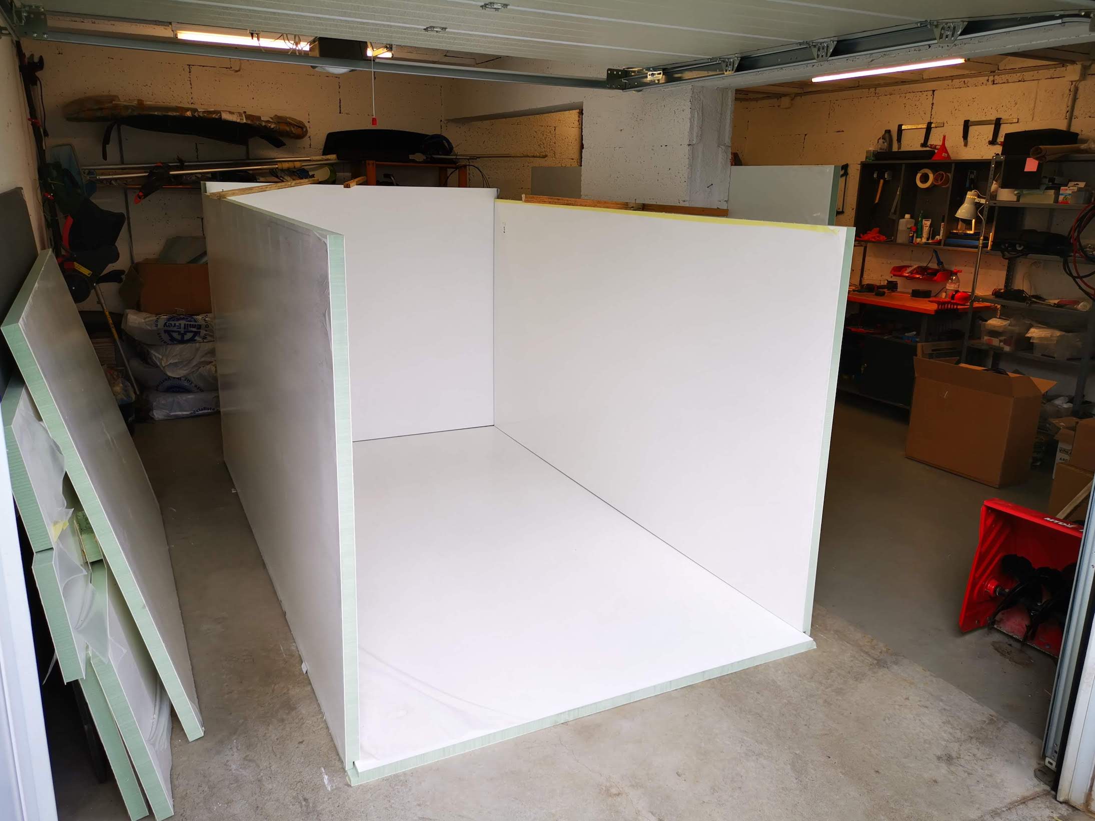

Little update,
received my panels for the box,
test fitting them in the garage,
removed tarp, structure and panels from Pinz
short video here:
https://www.youtube.com/watch?v=9mi3raqwi0I
short video here:

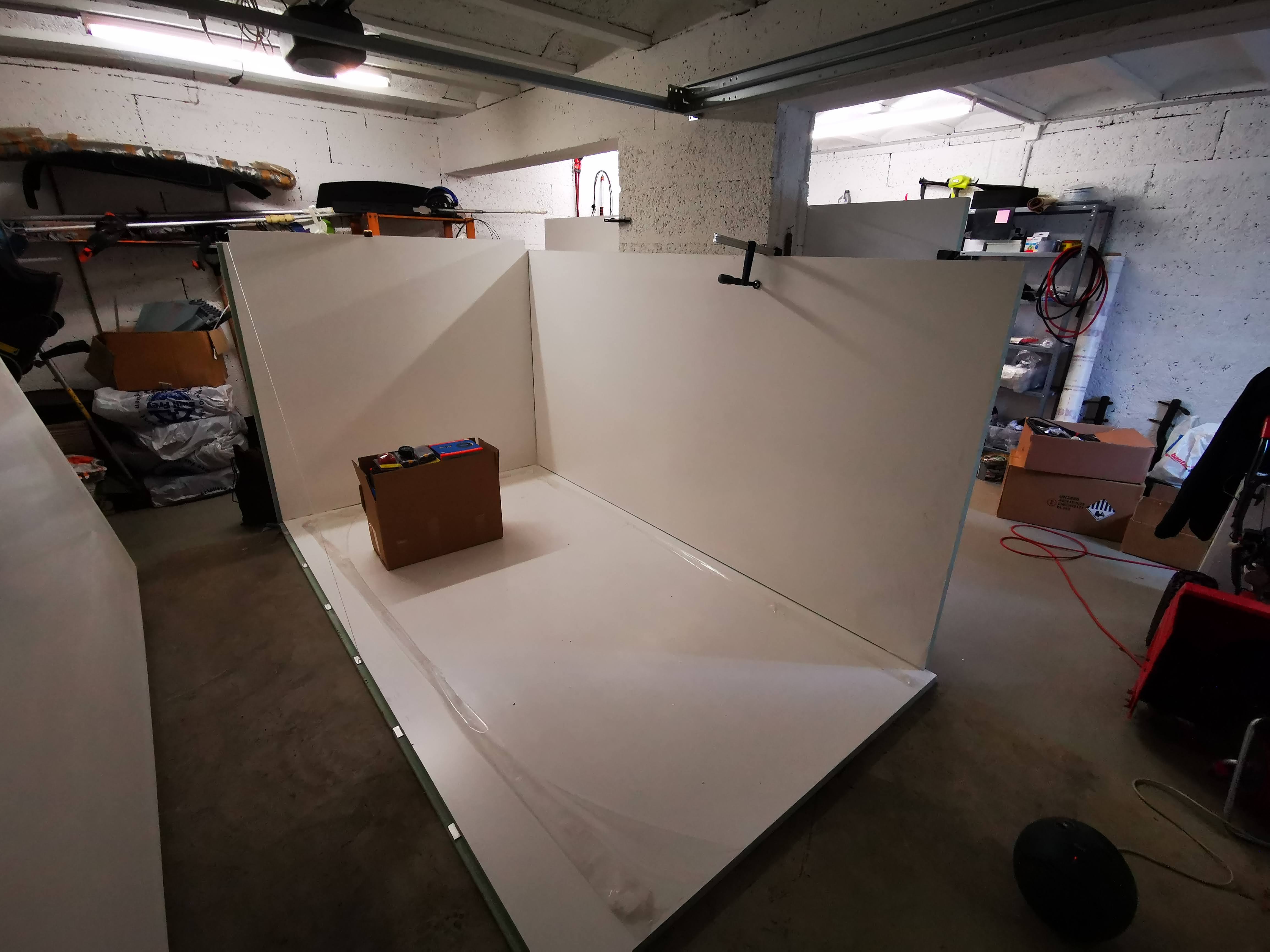

Re: Pinzgauer 710M Conversion - Build thread
Hi Ben,GadgetPhreak wrote: ↑Wed Mar 22, 2023 11:24 am Great build. I'm looking forward to watching your videos when I get a bit more time.
I use mine for Search & Rescue - there are some pretty cool videos on YouTube on how it's used
http://www.youtube.com/sarpinz
Keep the rubber side down,
Ben
I have definitely seen your videos and I must say they have influenced my decision to choose the Pinz 710 for my conversion.
Thanks for sharing
A quick pic from this afternoon,, just test fitting the front panel:

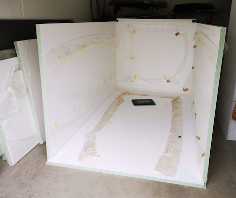

So, I started to glue the first panel, in the garage, the box is upside down,
so the ceiling of the box sits on the floor.
I've glued the base of the front panel to the ceiling.
More info in this video:
https://youtu.be/O26FWdpAwOw

All 4 panels glued together, they weigh 116 kgs / 255 lbs
starting to glue L fiberglass profiles
using Sikaflex 252
short video here:
https://youtu.be/534A8XhzAi8
using Sikaflex 252
short video here:
