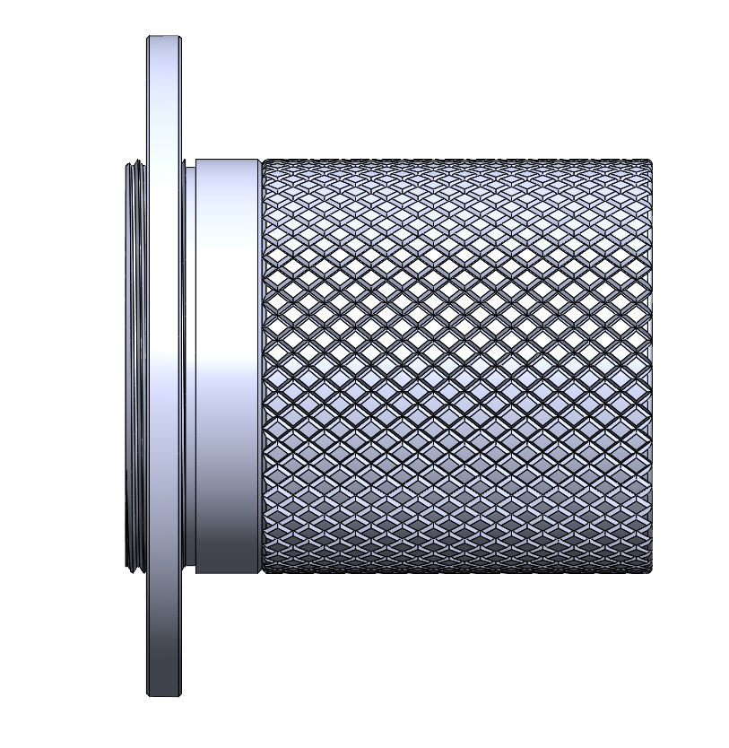

Here is my idea based on your dimensions. The two piece design keeps the price down and makes it so they are slightly adjustable to take out any play. I know that the main issue going this route is they could come lose but with some red loctite and the friction between the threads and the face against the hub I do not think it would be a issue.

This looks great to me.
I'm in.
How much would you charge me for it? I would like to buy 2 sets, for all 4 wheels.
Also, do we need some form of rubber pad between the hub step an the wheel, to eliminate rubbing of aluminum against metal?

Do you mean for the flange or where the center piece butts up against the hub or both? Since you can lock it tight I am not sure how much it would move and rub really.. The center piece would rub as its tightened but not sure after that but I wouldn't think the center of the rim would flex much if at all??

I would like to eliminate any rubbing against the wheel (if I can help it), be it flange or center piece.
Maybe some sponge tape could help achieve that.
I also think the center of the rim won't flex at all.
Please let me know the price and how soon you can have them ready.

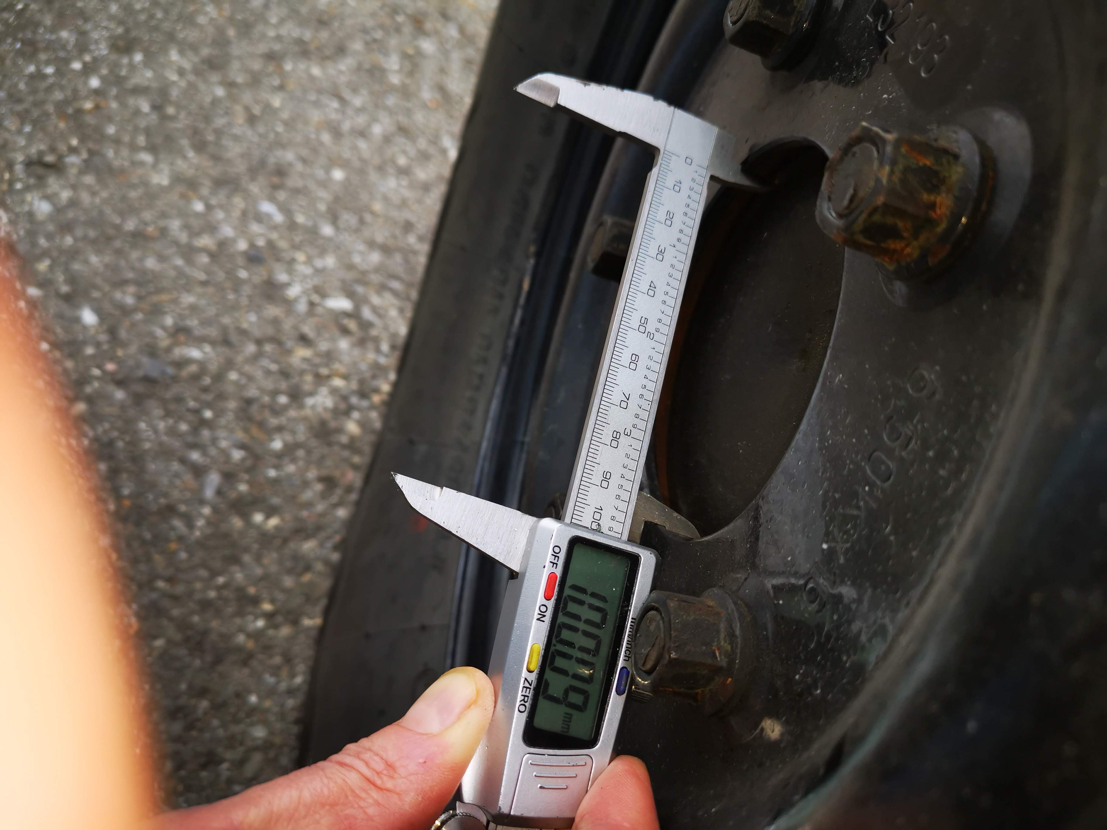

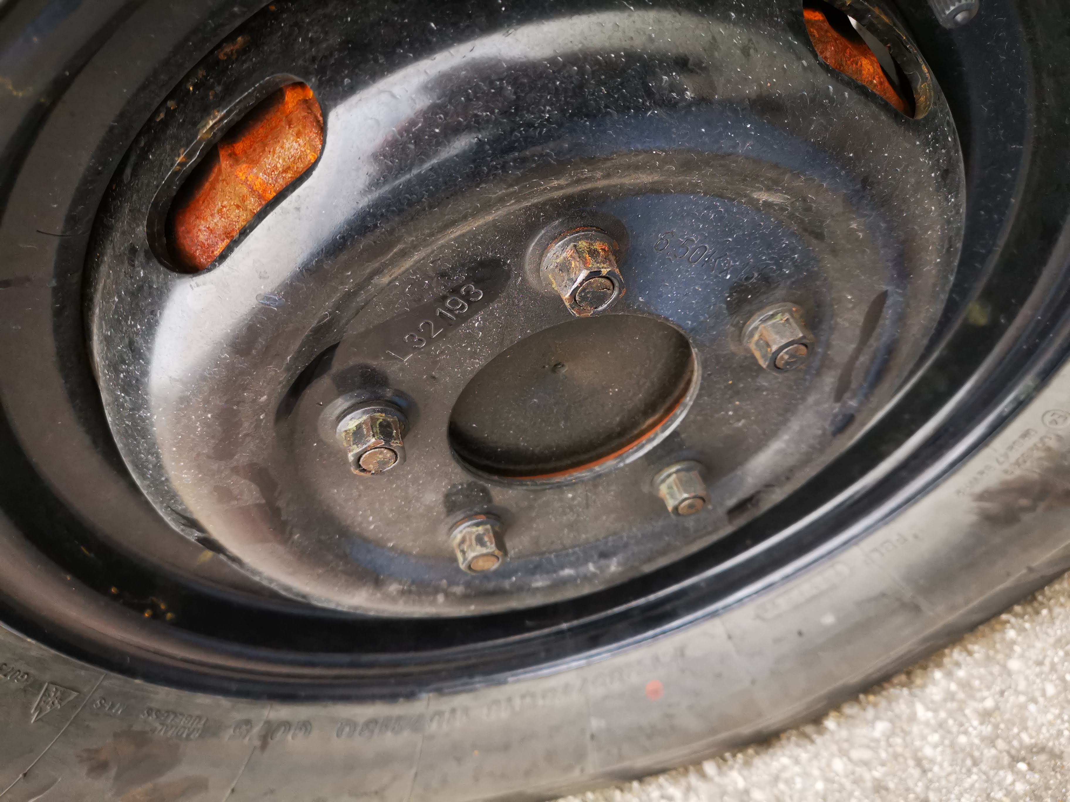

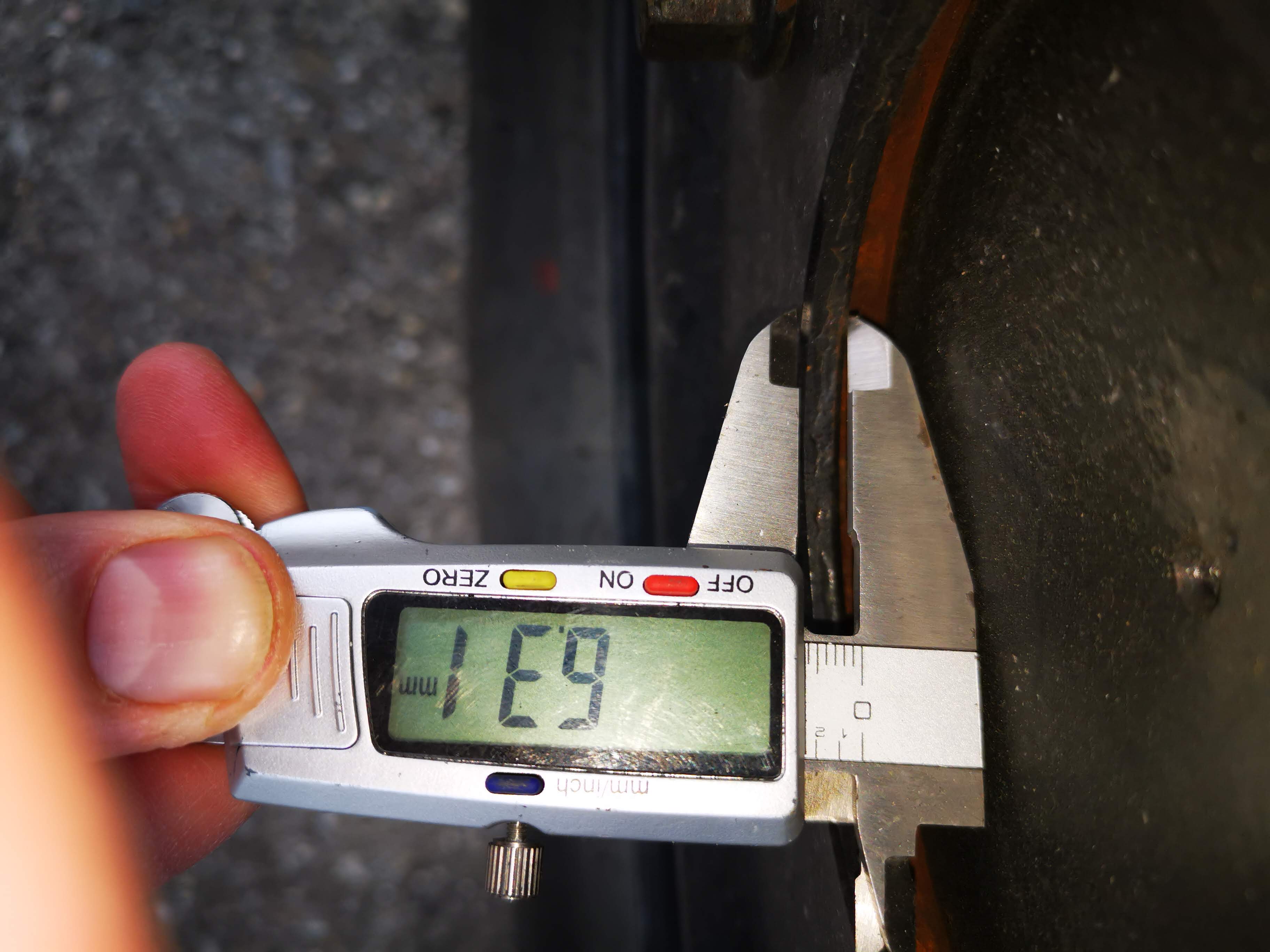

checked my measures today (mm), Pinz 710M ex Swiss army
rim closeup.jpeg (645.53 KiB) Viewed 11496 times
internal diameter.jpeg (387.19 KiB) Viewed 11496 times
rim thickness.jpeg (375.16 KiB) Viewed 11496 times
gap 8.8mm.jpeg (690.75 KiB) Viewed 11496 times
