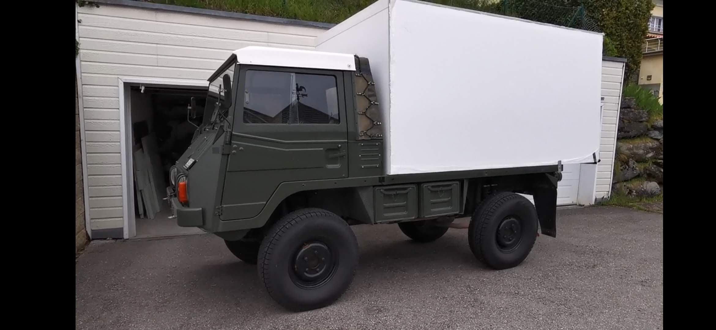

Box mounted on Pinz 8) 8) 8)
Same weight as the tarp and structure I removed, so net weight gain = 0 :D

Hello Hugues
Shouldn't you line the walls of your housing with a carpet or PVC tiles, for example?
to avoid excessive abrasion of the TPU of your tank on the aluminum of the box.
watch out for protruding rivet heads
irrelevant
if you had already planned it! :)
congratulations again on the progress of your layout
Eric
Hugues
Posts: 172
Joined: Tue Nov 29, 2022 6:08 am
Re: Pinzgauer 710M Conversion - Build thread
Post by Hugues »
Salut Eric
Good questions. I have not used rivets but low profile round screws which the head inside the box. Then I covered the heads with EPDM or foam tape.
Now, the aluminium sheet on the inside is flat and smooth. I'm not sure there will be a lot of abrasion on the PU. Maybe I can grease the contact surfaces, or put anti abrasion tape? The bladder once full is very snug inside the box, so there will be only small movements possible between the PU and the walls. I filled it with water now to test, I will then inspect it regularly.
