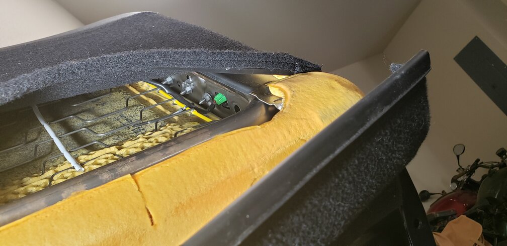

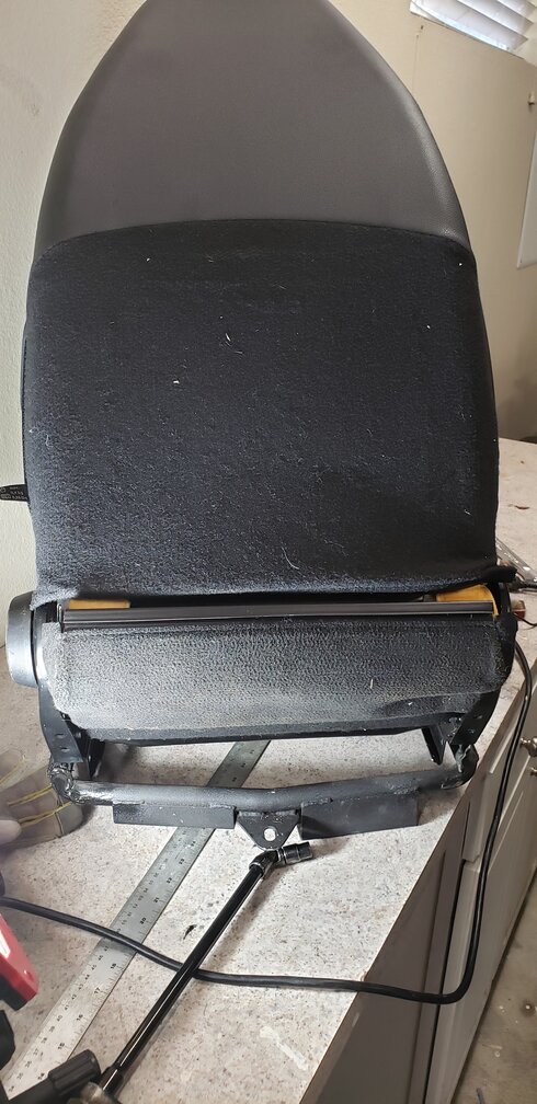

I figured it out. You pop open the lower back of the seat cover, which is connected with a sort of hooked seam you can pry apart. Then you peal up the back until you reveal the 3 nuts holding on the airbag, and the one connecter. Remove the nuts, pull out the connector and then you can pull out the whole airbag unit.

Did this over the weekend. Was able to remove the airbags and then put the plastic housing back in the seat, so it looks like it did, just no surprises.
Very easy to do
