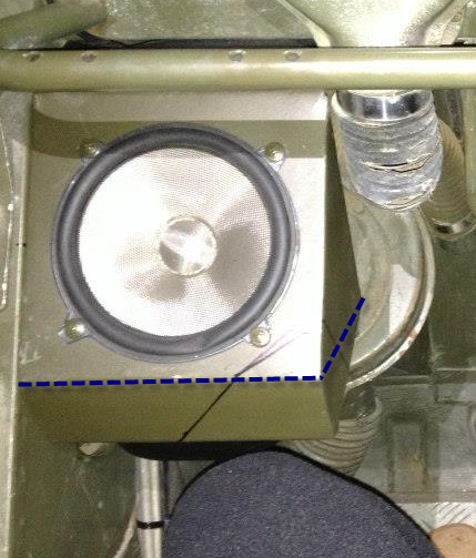

I'm not sure about proper but here's what I'm doing. Installed a 24v to 12 v 800watt converter behind pass seat with a 12v acc/lighter plug, and a 4 channel 50w rms x 4 alpine i had laying around. Next i built some 18g steel speaker boxes for some 5 1/4 infinity component speakers sealed with dynamat and painted olive drab (close enough for now) and mounted the tweeters right above the windshield bolts on a steel tab. Ran the fronts on the 1 and 2 channel bridged on high pass and 3 and 4 channel are gonna run an 8"/10" sub that ill be installing tomorrow for the lows. here's a few pics of what I've done so far.
Gonna trim the corner of both boxes when done so there are no knee dings. More pics as i progress.

Knee killers aren't as bad as they look but want to make it look like it came that way as much as possible! more pics to come.

Here's a couple pics with me in the truck so you can see knee space and shifter is in 4th. Gonna Trim boxes 1 1/4 inch.
Ok so i made a temp mock up sealed sub box to see what i could get away with regarding size and if that small 4 channel amp would have enough power. The 10" Kicker sub i had is a bit deep (4.5")so its a mock up as well.
with Scatt/Procar ralley seat pulled and reclined all the way back
Test results: Had to turn gain on front speakers all the way down to hear the sub with engine off with engine on its a joke = Need more power!
Picked up a Fosgate Amp and 10"sub. I chose the Amp for its size and power 8.5 x 7.5 x2 inches and 300w rms @ 4ohms (500w@2ohm)
The Fosgate 10" sub matches the Amp perfectly and is only 3.5"deep
The Amp will be mounted against the driver side panel next to the kill switch. More pics and results to come!

Could you not cut the lower part off and make it more like this?
Would gain a couple of inches possibly
Will be interested in your results once you have it all together

TechMOGogy wrote:Could you not cut the lower part off and make it more like this?
That pic is with legs spread (lol) gonna stick with just the corners or it would be a nasty wedge.
So I poop can the idea of the sub being behind the seat, sounded like crap.. not enough air space. I threw a 12"sub in a 1cu ft box i already had and put in the back facing the driver. Sounds bitchen! 40watts per channel to the front and 300w to the sub peak, although i'll be listening at about 50% of max vol.
