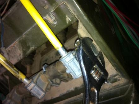

Then you can begin the process of taking the lever assembly out. It is held in place by two bolts/screws on either side. Note that there are lock washers with each screw. You will want to hang on to these so be careful when removing them. If you have trouble getting a wrench on them, you can pull the entire assembly out a bit with your hands to obtain enough room to take the bolts out. Just be careful you don’t crack any of the hydraulic lines.
First photo below shows a spanner wrench being used to remove the bolt on the passenger side. The next post will continue the thread.

The next pic below shows the bolt holding the assembly in on the drivers side.
Note that the screws/bolts that you are taking out are threaded into the shaft that the levers and spacers rotate on. So, be sure to keep everything together as you slowly pull the assembly towards you once they are removed. When you do, you will see the actuators/push rods pulling out of the boots covering the master cylinders.

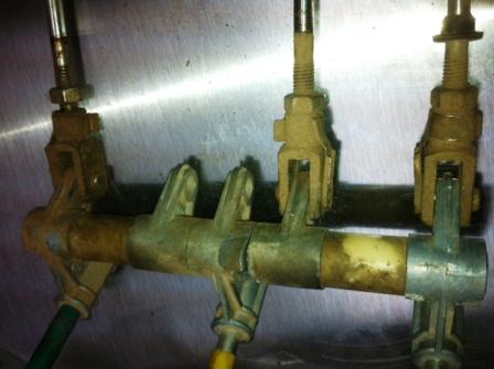

She looks like this removed from the truck.
Note a couple of things from the pic above: First, you can see the broken center lever. Second, you can see how the assembly works. As the lever rotates on the shaft, it pushes the push rod further into the boot and engages the master cylinder. If the lever is broken, as mine was, the lever will rotate on the shaft but will not engage the cylinder.
The center lever is a bit different than the two outer cylinders. The two outer cylinders directly engage the push rod. But, the center one actually rotates a spacer that has the actuator attached and it engages the cylinder. I’ll show you some pics below. Now that you have the assembly out it is a great time to clean it up, lubricate it, and make sure everything looks right before putting it back in the truck.

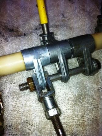

Above you see the clip in the top right corner of the photo and the push rod assembly at the bottom right. The piece in the center is part of the broken lever.
I performed the post manufacture upgrade I read about on the forum. You will note that the force of pulling the lever is all placed on the “tooth” that locks the lever in with the spacer that contains the actuator/push rod. The spacer next to the lever locks in place with the lever via a “tooth”. It is this “tooth” that takes all of the force when the lever is pulled. But, the middle lever has the same connection on the bottom that the two outside levers have that generally take the force of pulling the lever. So, I took a stainless steel bolt and slid it through the lever and the two spacers and put a washer on either side. I then put a dab of super glue on the threads and put a nut on the threads of the bolt enough to keep it from sliding around; but not tight enough to prevent rotation of the equipment. In other words, you want the bolt fairly loose so don’t really tighten the nut. It is merely to hold the bolt in place. Now, when you pull the center lever, the force will be spread over three components and not one. Here’s the pics showing the pre and post repair and upgrade.
This is the assembly before the repairs and cleaning were performed.
You can see the design I discussed above. Below is the replacement of the lever with the upgrade.

And here’s what the assembly looked like post cleaning, repair and upgrade prior to going back into the truck.
